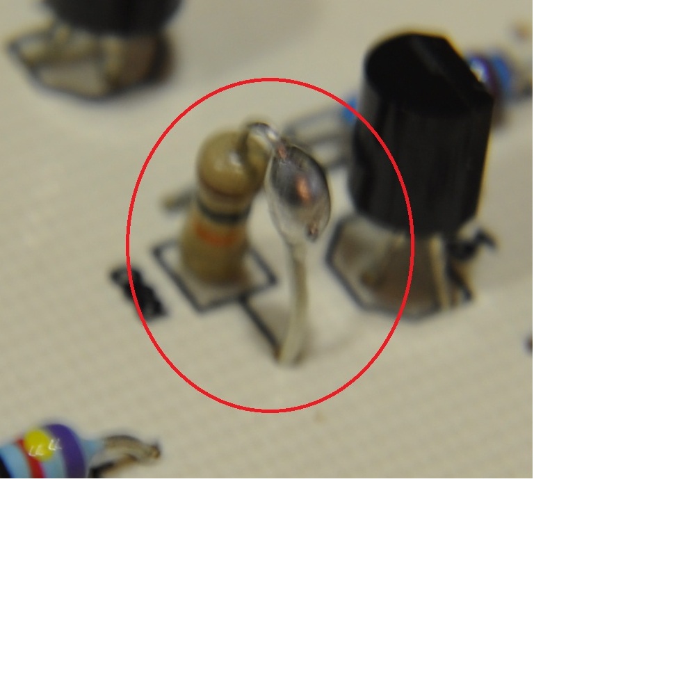

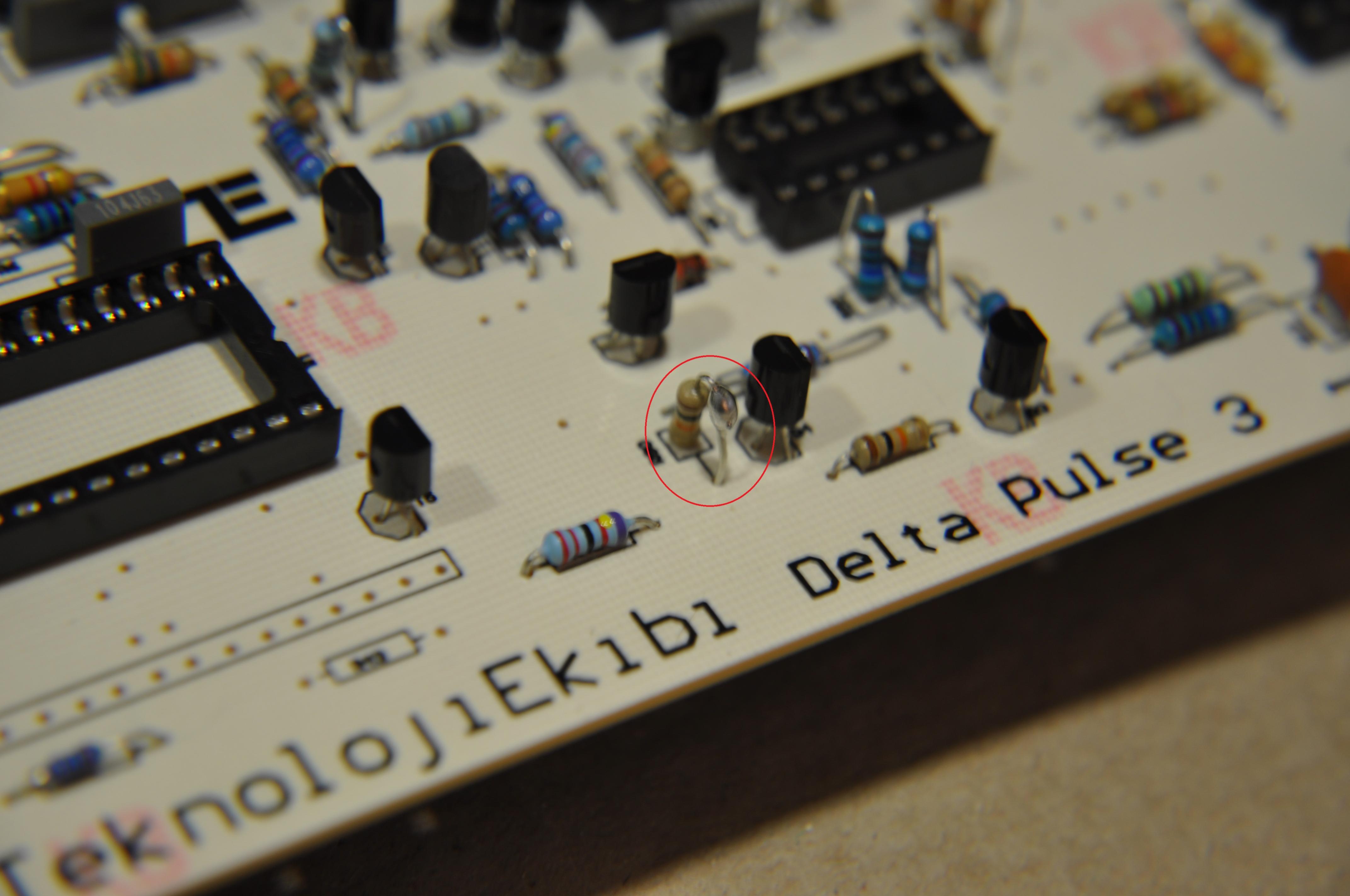

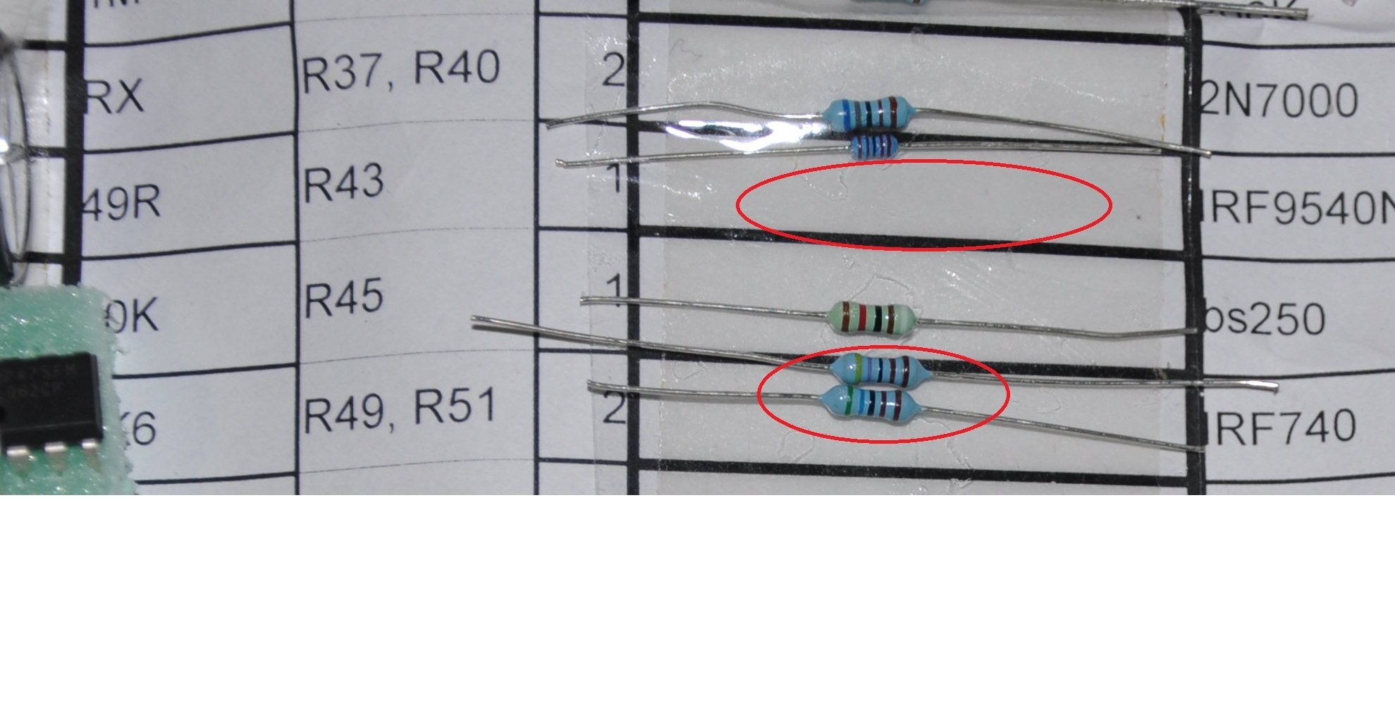

                      • Hi all,
                        a month ago or so I received the kit, and I have some doubts.
                        Can anyone help?
                        1 - I think the R43 of 49 Ohms is missing.Yet must be of 49 Ohms? Tolerance??
                        2 - Look at the R49 and R51. One is 5K6, but the other seems 4k7. Are be equal, 5K6?
                        3 - R52, R53, R55. I can not put this resistance in vertical, the wire is short.? Can I solder a piece of wire? Or do I buy another?
                        Thanks folks

                          • Sorry.
                            • Originally posted by Malibu View Post
                              Hi all,
                              Can anyone help?
                              [ATTACH]23518[/ATTACH]
                              Thanks folks
                              Hi Malibu
                              1-R43=49 OHM
                              2-R49 =5.6k must be ,,,,, R51=5.6k ~4.7k
                              3-R52, R53, R55,R59,R61=10K. Yes U Can solder a piece of wire.
                              Full wishes for the success to complete
                              best time
                              j.
