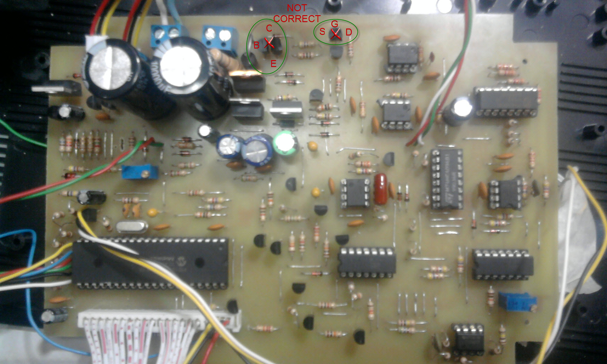

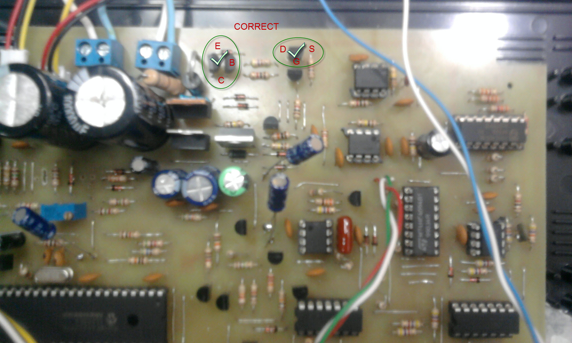

    Hi Nicolas
    -Remove all the components which depend on the +5v like glcd,pic,4094
    Then measure +5v on out of 7805 ,,,In order to determine Is 7805 or not Mistake.
    - 2n2097 180-degree wrapped
    - bs 250 Keep
    best time
    j.
    Hello Jap thank you for reply. for the +5v I resolved the problem it the connection to GLCD pin 1 is GND not +5v
    Yes I have changed also the two transistor 2n2097 because is bad placed- I return 180° yes is correct
    Also bs 250 I have return 180° because I have the type of bs 250 the drain is to the right
    http://www.alldatasheet.com/datashee...DES/BS250.html
    Now the IRF 740 is not warm

    • Hi Jap
      I checked all is correct now. The 2n2097 is correct and BS250 following diagram and picture I attached here. the IRF740 not warmed
      I changed another PIC 18F452. Now all is correct.

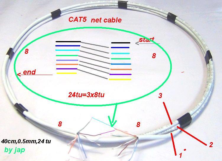

                  • hi Jap
                    is a good coil for dp2? thanks
                    do you have good coil for dept?if give me i so thank you bro..
                    • Hi alonejax
                      -try with Coil-Calculator to test .
                      http://www.geotech1.com/forums/showthread.php?17909-Coil-Calculator
                      best time
                      j.

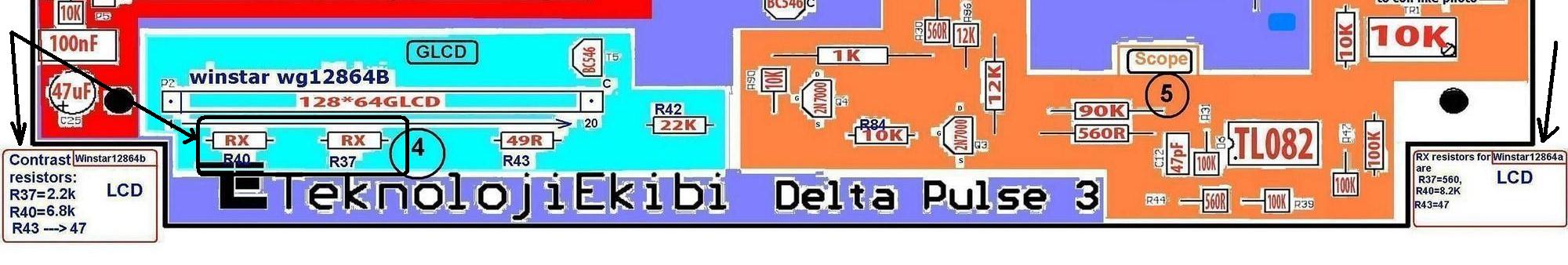

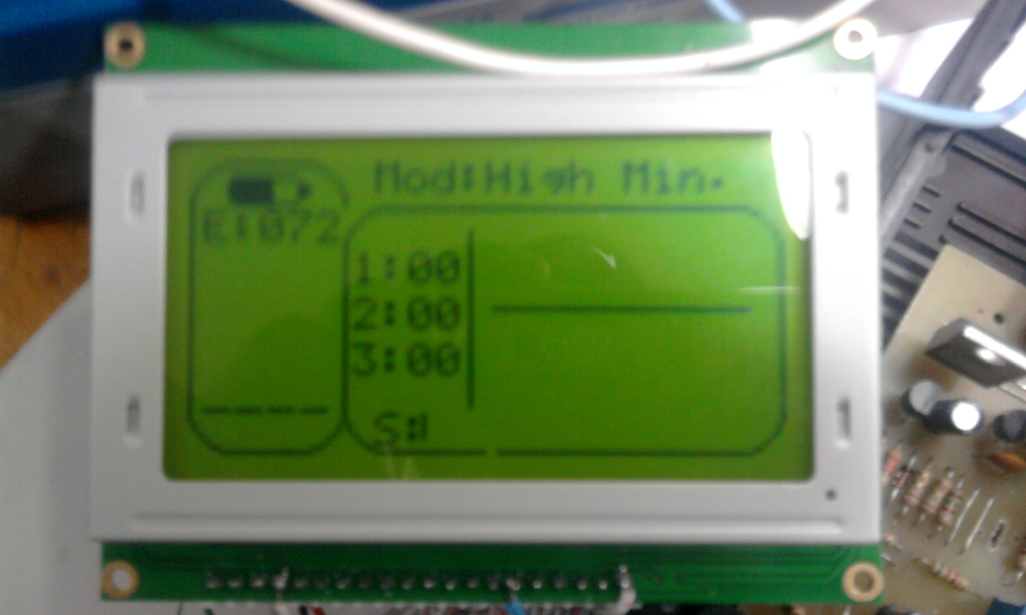

                            • I do the DP3 three months.Did not succeed, my WG12864B can not display properly, I suspect that the HEX file can not be applied, I am very disappointed
                              • Originally posted by liudengyuan View Post
                                Hi liudengyuan
                                -IF U HEX file can not be applied-->U cant ON
                                -test u connection!
                                -TEST +5V
                                -test contrast R37,40,43
                                best time
