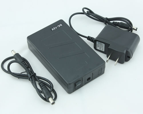

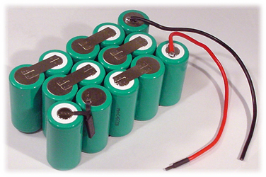

                    • Hi all, thanks in advance,
                      Please I need your council concerning the appropriate battery for my DP3, I already used : 12V6800mah and 14V1000mah see pictures
                      the first no much power to run the device, and the second, my device shutdown just after 5min.
                      I will order new 12V battrey, witch performance is better, how AmperHours at least I will need?

                                Please Mr Jap give me idea about the appropriate Battery to use.
                                Good luck all.
