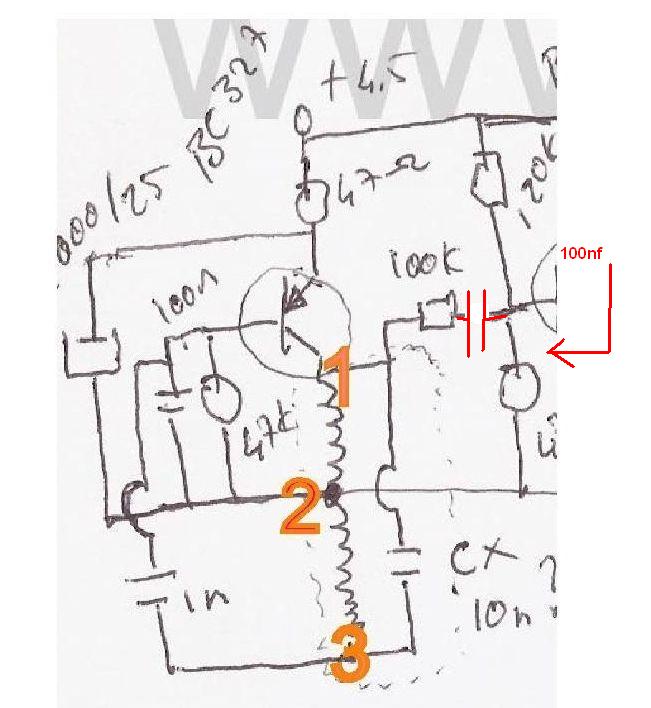

    hay guy s I have made Tarsus metal ditector but its work only short distance Idont know whats Ploblem with it Can some one guide me

        yes got scop 20 Mhz the tarsus working nicly but withe big things like coc & pepsis tins the osilator wave Rx13.071khz and TX12.500 kHz
        with out Auto tune see the Atachment

              Oh my... you should be detecting even tiny coins at 25cm.
              To start with, check all voltages. Do you have the correct voltages to your ICs?
              Also, be aware that there was a mistake in one of the schematics.
              How does your coil null look? What is the residual voltage on your Rx coil?
              What is the peak voltage across your TX coil?
              What version did you build? There is one version with a self adjusting threshold and one without. Had trouble with one version with SAT.
              Don

                TX ACV 18 Frq=12.500 KHz
                RX ACV 0.28 Frq= 13.5 KHz
                and the capasitor is there C20 =100nF see scham diagram

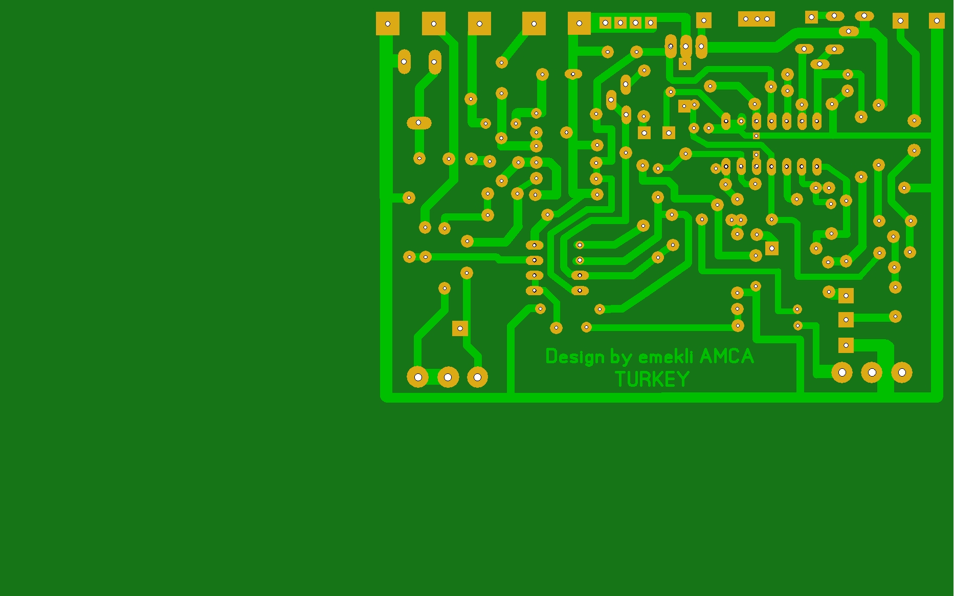

                      hi to all i am make one tarsus is not work just There is no sound headphone Coil disk does not answer to any metal Any solution to the problem of used this image for printing
                        All Ceramic Capacitors 100 volts i need know the Watt all resistors؟؟
