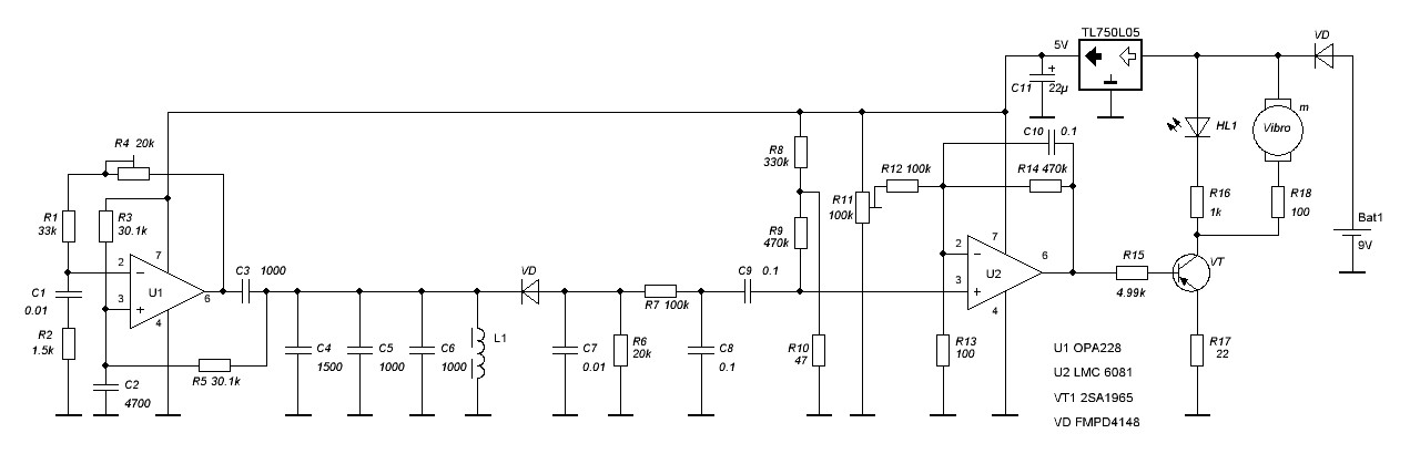

      Garrett THD tactical hand held metal detector schematic

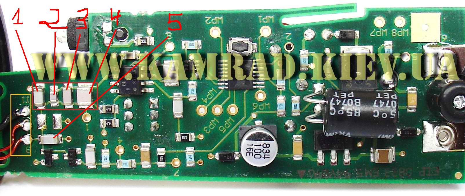

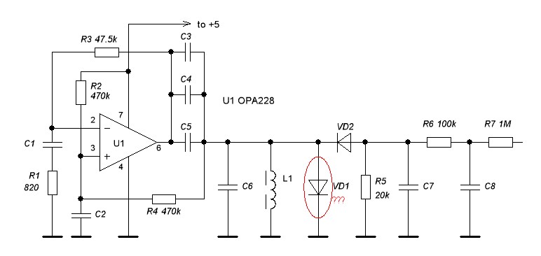

        Garrett pro-pointer pinpointer schematic and PCB

          Do you by any chance have a complete schematic with values of ProPointer? I have a few odd ideas about it.
            I take the schematics from RU zine. that I see. its are not mine. left part of the schematics are similar, but Propointer has right part released on u-controller.
            this is all info on today.
