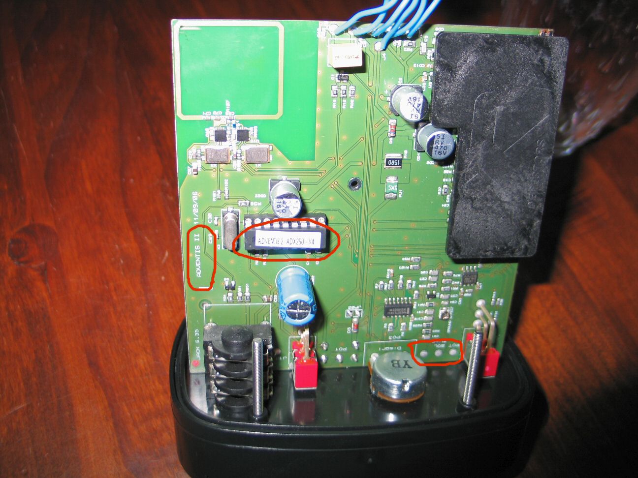

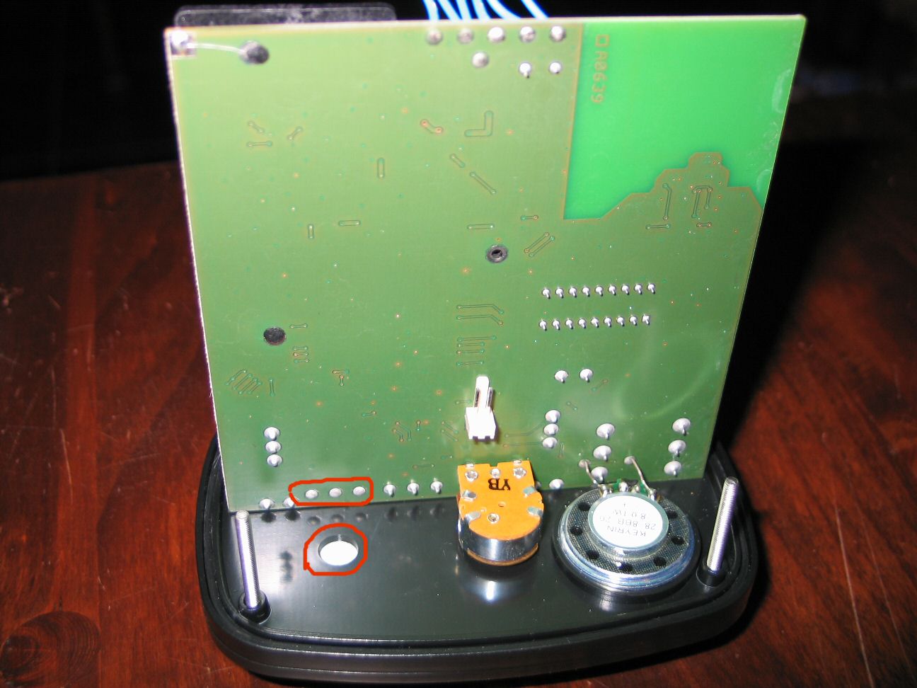

      The cable was broken,and burned the panel.the problem the no name pic and the xp1,xp2 cristal.I dont know what is the pic type and the xp cristal type!!
      Sorry I dont write correct maybe because i dont write english very good
        The xtals are unlikely to be damaged. The IC's could be damaged, but you only need one to work, there are two because the detector can transmit on two frequencies. If it is impossible to repair, you could disconnect the transmitter circuitry and just use normal headphones.

            at photo ADX250, not ADVENTIS-II.
              I'm sure it is the wireless headphone transmitter circuit. Could be 433MHz FM, in which case the 'crystals' are actually SAW resonators, and the IC is a FM modulator. But it might work at radio-control model frequencies, 27MHz, like a lot of cordless PC mice.

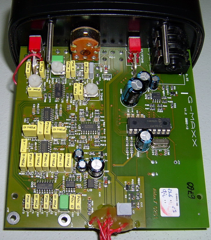

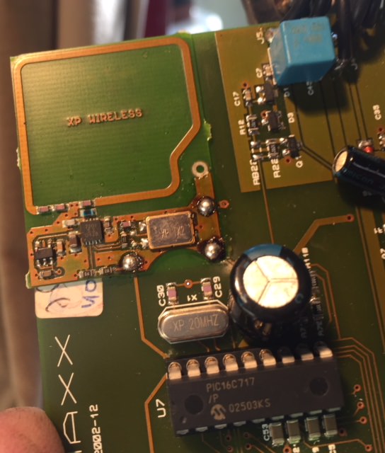

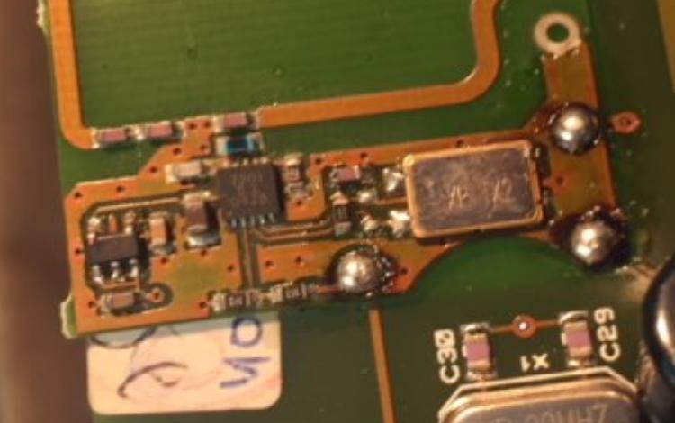

                        An update with some technical info:
                        Over on another forum, a guy posted an internal picture of an XP GoldMaxx, with the optional 433MHz ISM radio transmitter module installed.
                        I've attached the pic, and a zoom-in. It's a single-frequency transmitter, the later GoldMaxxPower ( and GMAXX2 ) had as standard a dual transmitter circuit, giving two selectable operating frequencies.
                        You can just make out the transmitter IC is the Melexis 72016 part, as I speculated in my earlier post.
