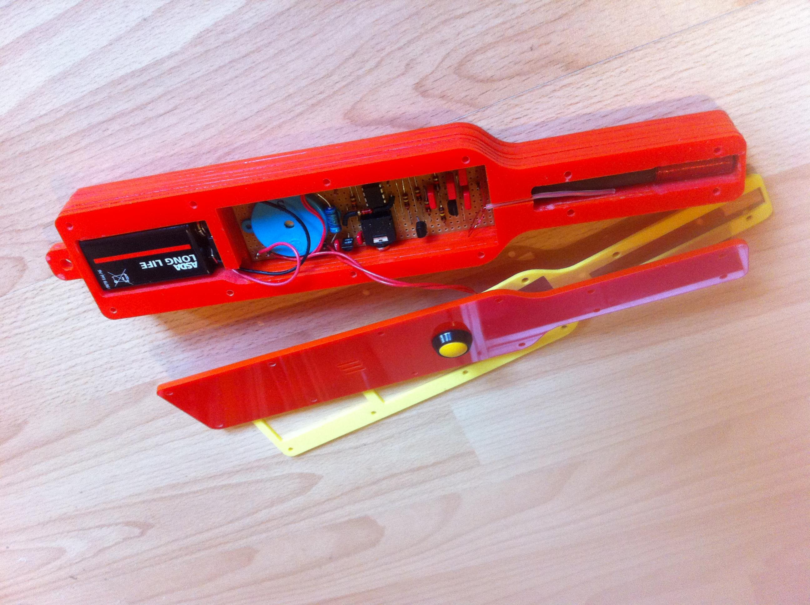

    I've been looking about for a pinpointer probe that was fully automatic, and wouldn't break the bank.
    Sadly, I couldn't find anything that was fully automatic (like the Garrett pro pointer) - no pots or adjustments, so have resorted to rolling my own. I had a good look through the forums before posting but didn't find anything.

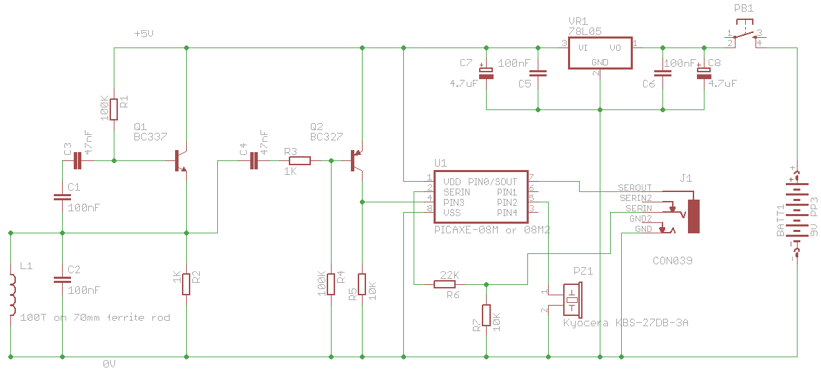

    This project is nothing original really, just a fairly standard colpitt's oscillator strapped to a picaxe microprocessor (picaxe is programmed in basic). I've used various flavours of picaxe over the years and like the easy way you can quickly lash up a project without resorting to buying a full blown development system (you can get up and running easily with their USB in-circuit adaptor - or make your own - http://www.picaxe.com). Above all, the picaxe is cheap (I mean REALLY cheap, the 08 device is only 1.80 GBP!)
    At boot-up, the processor measures the oscillator frequency and stores its 'calibrated' value (it counts the number of oscillator pulses in a fixed gate time). If metal is detected, the oscillator changes frequency then if it's over a threshold value, it beeps - that's essentially it. No bells or whistles, it doesn't monitor battery voltage, light LEDs, tweet the results, record it's GPS location or flash a big light in the hole.

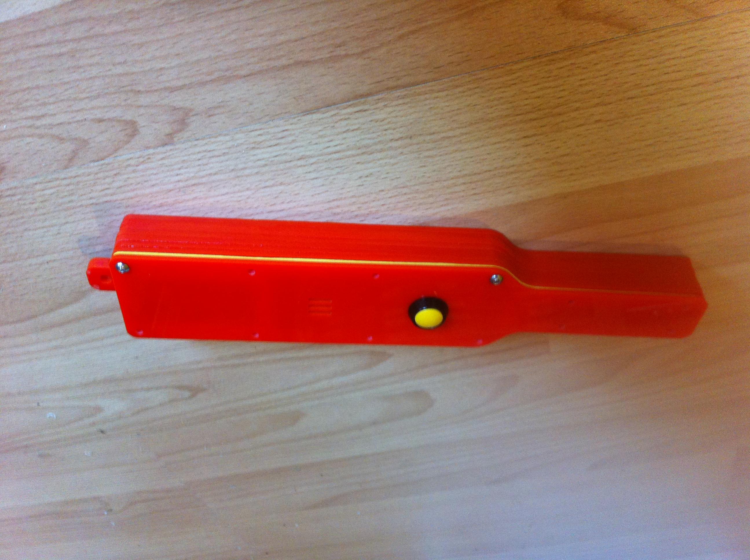

    Sensitivity is about 20 to 25mm on a UK penny (about the size of a US cent) - I would have like a wee bit more, but this is fine.
    I struggled to find a decent enclosure for the electronics, so ended up rolling my own again. The box is just layers of 3mm scrap perspex stuck together - again, not original - I cut all the layers one evening with a fretsaw and file (that would be sad, I have a laser cutter that I built :-) I also cut a foam gasket that seals the lid - the hole for the piezo sound is masked with some mylar film stuck to the back.
    I've attached a couple of pix of the project, the source code for the picaxe and a rough schematic - no PCB, it's easily done on veroboard - if anyone wants to produce a PCB, feel free !
    I'd be interested in anyone's thoughts on increasing sensitivity.

          Nice Job Neil
          pinpointers have been a bit of a favourite of mine, I've made a few
          my most recent is here http://www.geotech1.com/forums/showthread.php?t=19005
          bunching the windings all towards the end did seem to help with distance
          In the video I was using a US cent and could get 5-6cm
          Power is very low and works well with 2 x AA
          Only negative is the probe requires movement to detect, a static probe would be much better
          good fun though

              I like the second version, the multivibrator may be a better solution - more of an 'unstable' oscillator - probably pull off frequency more. I'll maybe give it a try tonight.
              Thanks for that.
              @silverdog
              I tried various coil setups - pile wound on ferrite, air , in line - to be honest, there was next to no difference between them. Thanks.
              This FM system is very stable though (or it can be if the 'threshold 'is set high enough).

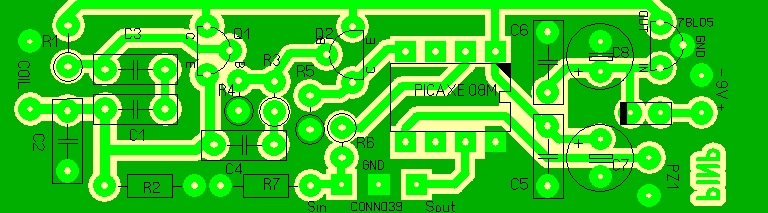

                .......can have errors....made it between 2 beers... ... if you spot errors please tell ( or other adjustemts)
                Now the second from the two beers..
                Best regards.
                Ap

                      Hi Ap
                      Ok on the PCB, that was quick work!
                      Looks ok, the programming connector doesn't really need to be on the board anyway - although it's useful for debugging/changing the firmware. Its been a couple of years since I used eagle seriously - its amazing how easy you forget (age might be a reason too of course :-)

                      Tried the astable oscillator on the russian probe, no joy - could barely get it to oscillate. I see there have been some changes to the osc - including using the one from the minimax. You can almost transmit to Oz with that one LOL
