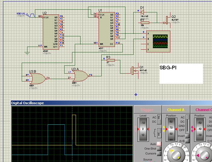

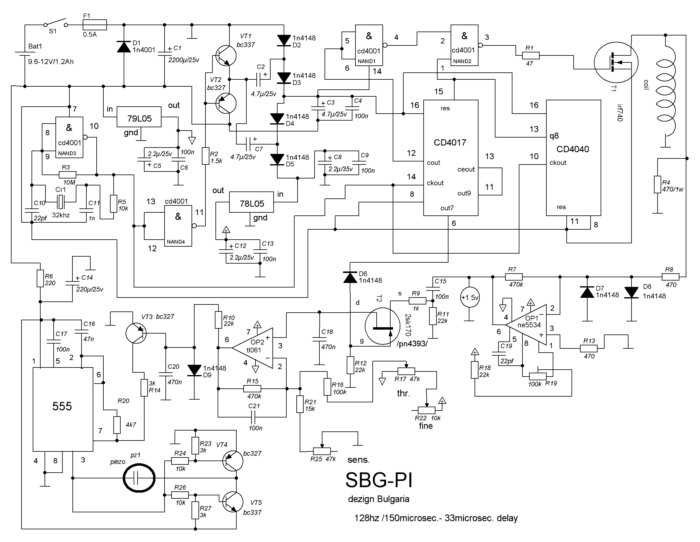

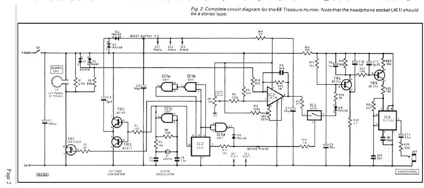

                    Hi, this scheme is not designed to SASHO, this is just a EE treasure hunter based stabilizer for operational amplifiers, and change cd 4016 with cd 4017 maybe if cd4001 cd4011 replace with will be better if someone has time to try it. Because in this scheme sometimes has a problem because the oscillator quartz often burn, we will prevent this, but it will be in next version VANDAL PULSE 2

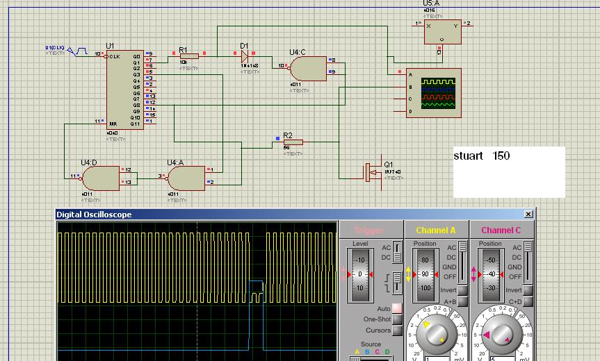

                        Why copy the pattern of Sascho? Why do not Stewart 150? Is not it the same? Maybe you know of electronics as a horse in astronomy.

                              Here's how work two schematic. Is identical?
