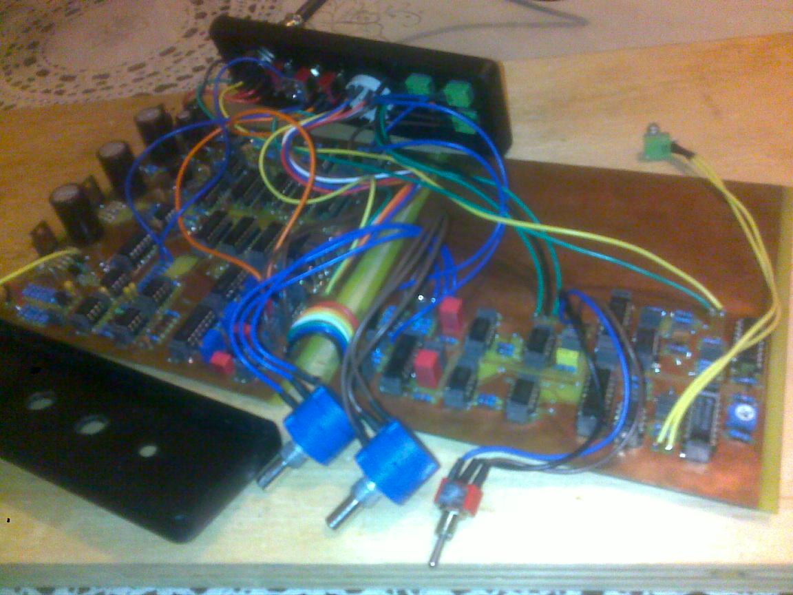

    Obviously the topic is difficult . I have attempted to create PCB of this device. It was a pretty well-at least I think so. But I can not implement them due to lack of time. Rose 3 PCB with dimensions 100 mm X 140 mm. There are some errors but time will tell. Can anyone say whether it is worthwhile to copy this unit. Thank you . Sorry for bad English but translated by google translator

      Hi you could not imagine how difficult is to draw good PCB for SD2000,
      Building SD2000 is more then worth you will see .

        I made boards DIP elements but I'm not sure it will work. Bothers me that the scheme has some inaccuracies. I think it gradually revived and began the first of the power module and sound-they are on a board. The second is the generator of the transmitter. The third PCB is the receiver, demodulator and filters. Google translator is ......
          Hope i unerstand you
          You can't use DIP packages for SD2000....

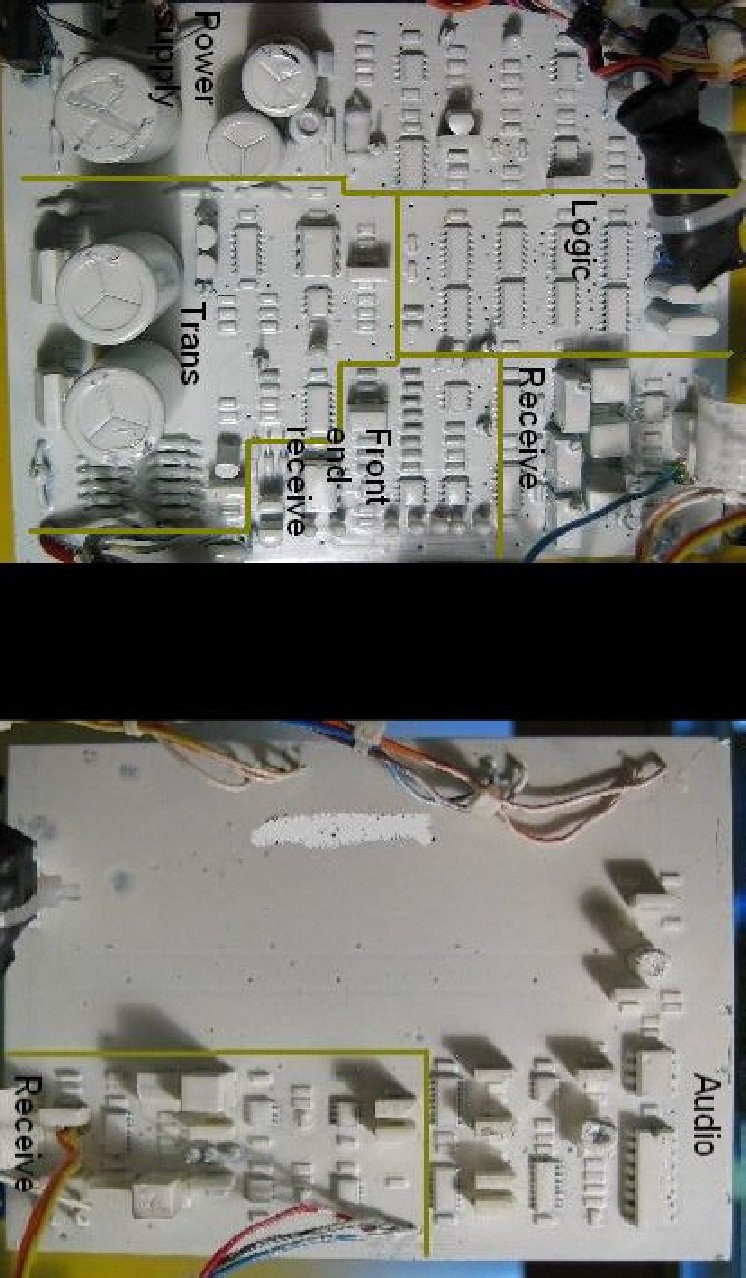

          this picture will help you....

            Thanks, Still Picture these have them. We see our baby and I can not write anymore ...
