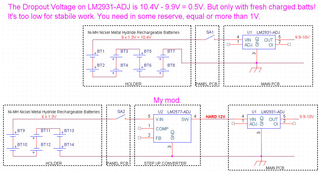

    I need a schematic for the excalibur, mine went down and I need to try and fix it. Thanks William
    I believe it is similar to Elite. you can begin to check power supply. try find LM2931 in SO-8 and check output voltage.
      Excal
      Thanks kt315 for the reply to my thread. I was able to get it back up and running today, I got some water in it and it just wouldn,t respond to any metal at all. Thanks William
