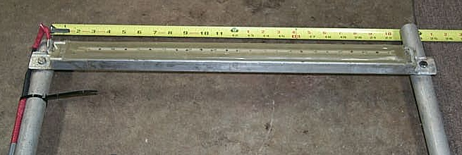

    I'm trying to put together a 200 kHz array, rather than learn by my mistakes $$$, I was hoping to learn what will work, and who to get it from cheaper. I been following your message board for a few months now, and you guys are light years ahead of me but I'm learning. If anyone has had any success building an array I could sure use some help.

          I have that 200kHz ducer I made and I can lone it to you if it would help your work.

                  Re: Need Piezo Help
                  Hi Tod.
                  I am trying to do the same with two echosounders one using paper and the other a collor CRT, on 200 KHz.
                  Can you provide me the reference of the 12 transducer-ellement trade house and cost. I should like to assemble an transducer like your on the foto.
