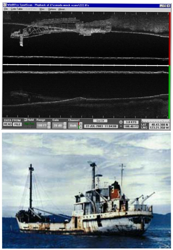

            Most of what we do is off the Oregon coast. We didget up to Canada just a few weeks ago and dove some of the artificial reefs there. I have attached a scan of one.

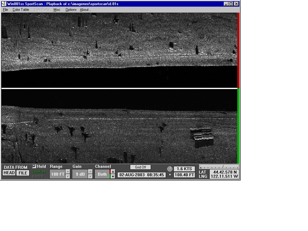

            This past weekend we scanned a lake and did a practice dive with a home built ROV. I have also attached a scan from there. I has an old foundation approx. 17' x 30' x 3' high. It is in 72.

              Here is the artificial reef scan.........
