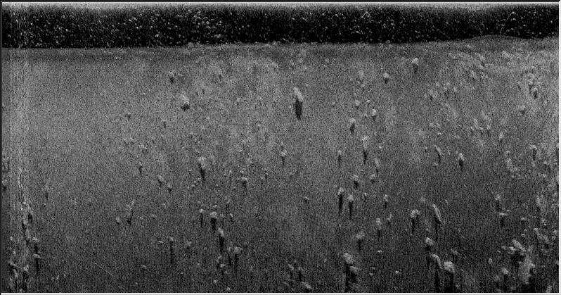

    The units that I have built and am in the process of marketing are based on Lowrance echo sounders (fish finders). They record data to MMC cards which is why I use them. They have custom external microprocessor circuitry added to them as well as custom made transducer. You will find many more images in my other postings over the past couple months. Here are some rocks in a 100 ft range.

      Hi Garry,
      your picture looks really nice! I did not find any pictures posted by you in the forum search, did you post them under GBurton?
      Which unit from Lowrance do you use, and can it save the sonar echoes as raw data, or does it only save the sonar display data? I have the Lowrance X136 DF, and the mode that comes closest to a normal sonar mode with gray levels is "fish reveal", but it is a mode that is a little bit of a mixture between gray levels and grayline. It is possible to supppress grayline, but not completely, because then the gray levels are also reduced . The normal fishfinder mode paints weak echoes black on a white screen and adds a grayline to stronger echoes (if you enable grayline). That´s not so nice for sidescan, one reason why I thought about feeding the signals to a notebook. But if other models can save the raw data the complete systen would be more compact.

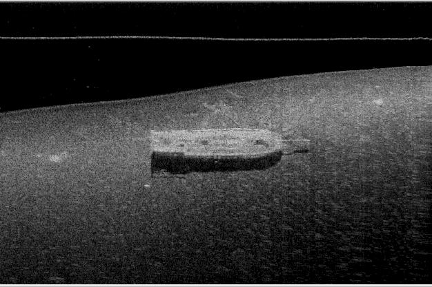

        There are a bunch of shots posted by me under G.Burton including shipwrecks. I will post some again below. The sounder I used for these images(raw, no'photoshop')is a LCX-15mt.
        Other Lowrance / Eagle models are also useable, but all of them I know of have an annoying problem when used for sidescan that I have removed to a large degree with external propriatary microprocessor circuitry. These sounders record raw image data that you can 'colorize' etc on your computer. I generally run zero greyline and reverse greyscale to give a more recognizable positive image. None of them will work for sidescan imaging without a proper imaging transducer.

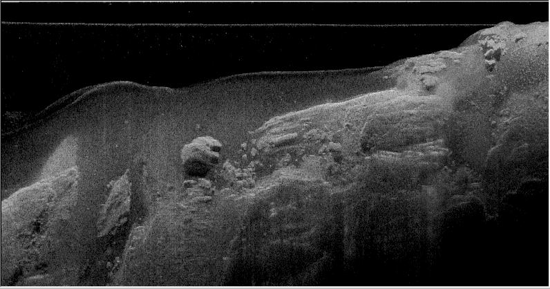

          Here's another, bottom details....

              Really very nice sonograms, congratulation!
              Did I understand you right that also the LCX-15-MT has this problem that you cannot display the data in a normal "clean" gray level mode without grayline? But the data that are being saved are raw data, not display data, and they can be displayed with the help of a program that you wrote by yourselve I suppose?
              I just read the manual "LCX-15MT_0133-49.pdf" that can be downloaded at the Lowrance website, and there is no hint in the manual to a mode with gray levels only. They also give no information about how the data are stored on the mmc card.
                Re: Who has any results with fishfinder sidescans?
                Thanks. I believe the recorded data is raw data as you can manipulate the heck out of it, change gain, color etc on a recorded file, just as if you were making such adjustments real time. GPS and other data are also imbedded in this file. I have no idea why they are so lame in their advertizment and documentation of their recording ability.
                The greyline functions seem to change the display 'gain' as it detects targets of a certain strength. I believe it was done for better target separation. It does wierd things though when trying to get photo type images in a sidescan application as you look at them in real time, which is why I prefer not to use it.
                The problem that I wrote about is something completely different and is inherent in trying to use these sounders in a sidescan type of mode. They are not ment to be used that way. The problems involve stability and there are several of them.
