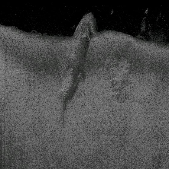

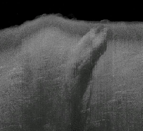

    Hello,
    Here are two samples that I shot yesterday with my homebuilt side-scan.
    It uses 6 pcs lowrance 20 degree / 200 kHz transducers with paralell connection. As you can see there is some optimizing to do still...
    Unfortunately I was impatient enough not to let the glue dry enough so I got a leak in the fish, but I think the transducers were not damaged.
    Its so much fun to see that the theory works in practice!
    Henrik

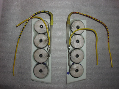

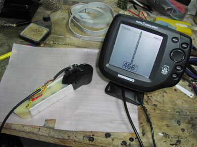

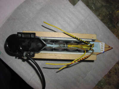

                          Thank you Rickard,
                          Below I post 3 pictures what I did. The black transducer is the Huminbird original ducer and the other 8 ones are 455KHz piezos I put before on ketone.
                          After welding and wiring them in parallel way I glued epoxy using a wooden box to fix temporarily. My mistake was using sintetic foam beteewn two rows of piezos and the epoxy resin react with that foam.
                          I would be thankful if you e-mail me the code for entering into 'super user mode' and how I can implement it.
