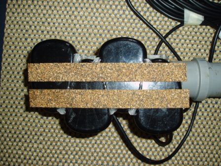

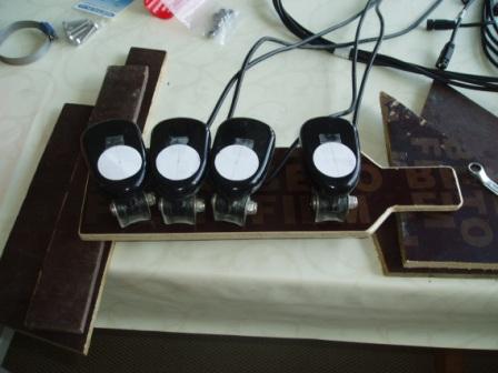

for new material for a new sidescan array I resimulated and rebuilt my old array (the old one is described under the thread "Functional fishfinder sidescan"). The old array did not fulfill all my wishes on performance and I was close to conclude that good arrays based on the principle of unequal spacings are almost impossible.

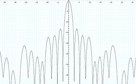

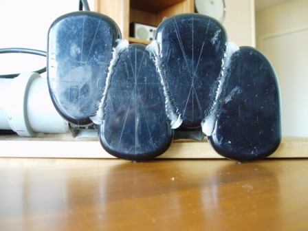

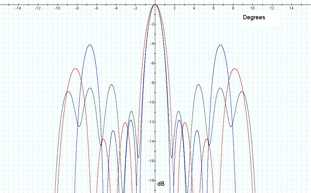

However, I found a new way to arrange my transducers so the minimum distance between piezo centers became 51 mm. The new array has the following specifications: piezo diameter - about 38 mm, 200 KHz, four transducers, interpiezo centerdistances: 51, 103 and 189 mm.
The new array is much shorter than the old one but the expected sidelobe suppression is -8 dB. The old suppression was -4 dB. (Remember, -13 dB is the theoretical limit for unshaded arrarays). Various tests showed that the instrument (Humminbird Matrix 37) displays echos down to about -8 to -10 dB so there was hope for only minor influence from sidelobes. Indeed, this proved to be the case.

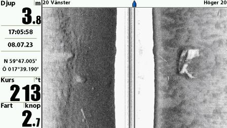

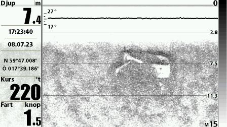

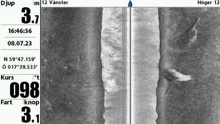

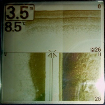

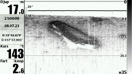

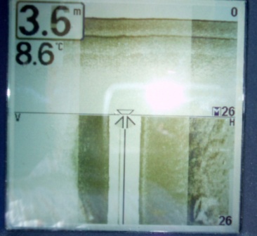

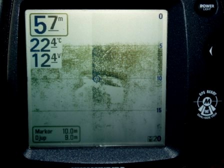

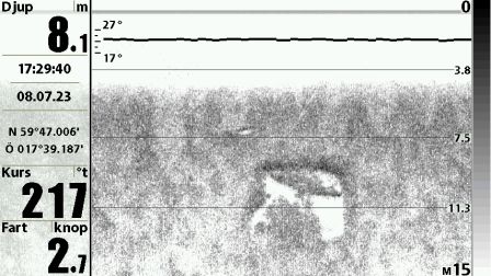

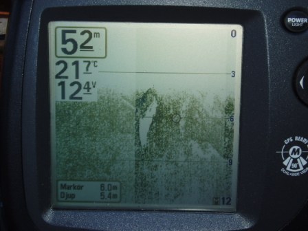

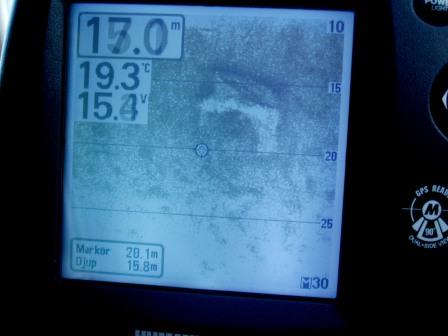

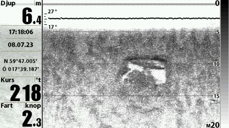

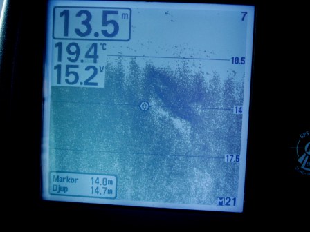

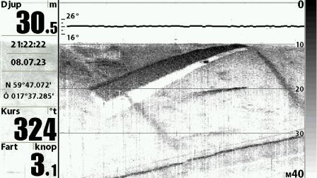

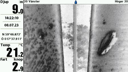

Attached are a photo of the array and some photos of a small new wreck I found when testing. The wreck lies at about 5 meters depth. I scanned from several sides.

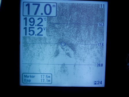

One photo shows a boulder and some smaller rocks. Much more welldefined shadows than before. In the shadow from the boulder one can see how sidelobes contaminate the shadow at the edges. But but the shadow limits are still clear.
