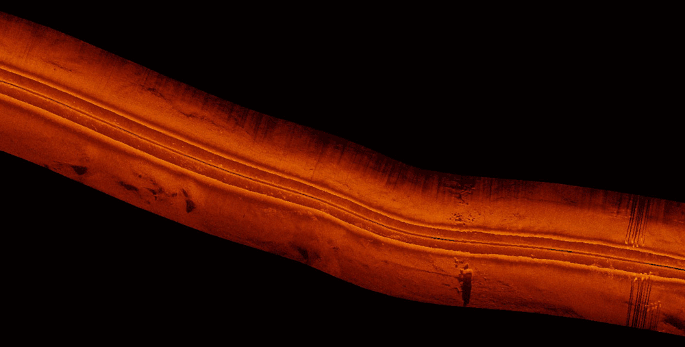

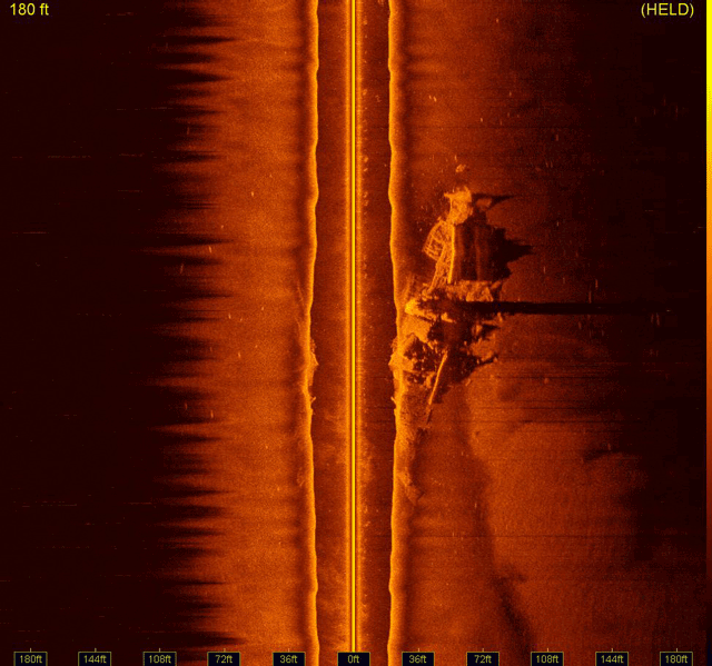

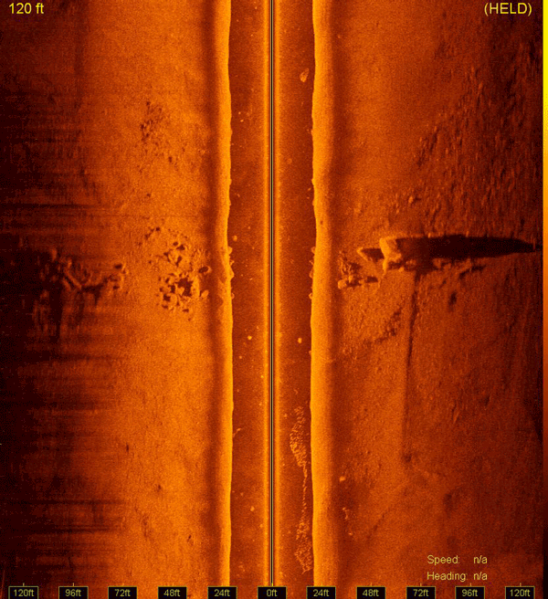

    I just wanted to update this topic. Several of us have been working on a Player for the Humminbird Sonar files and I am happy to say, I have found a solution!
    I wrote a piece of software that will convert the SON files over to YellowFin .872 format for playback on their free viewer. We are also working on finishing a dedicated Humminbird Viewer since there are some limitations and drawbacks to the 872 format. But there are also some plusses!
    Here are a few screen shots from some of the recordings that were recorded with my Humminbird 987cSI with the transducer hull mounted.
    I will post more info on the program next week. I hope to have a release by Monday.

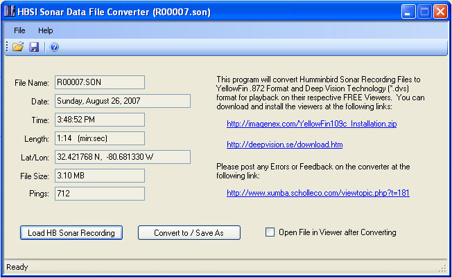

    Humminbird Sonar File Converter - Download!
    Well, Here it is! The following link is to the HBSI Sonar Data File Converter Windows Installer download. The program will convert the Humminbird Sonar Files to different Sonar File Formats that can be played back on the PC with the corresponding viewer.
    This release is 1.01 and includes the YellowFin .872 Converter and the Deep Vision Technologies .dvs Converter. You can download the Viewers at the following links.
    YellowFin109c_Installation.zip
    Deep Vision Technologies - Deep View FV
    The YellowFin Viewer is by far a more capable Freeware player and offers the option to save the .872 File over to XTF Format. Deep Vision offers more capable Viewers on their site, but they are not Free. They do offer the DeepView SE that will do playback and mosaic.
    There is a help file with the program and links to the downloads above as well. If you have any problems with the install or any questions, please use this post as a support forum. We would like to hear feedback on the Unit you use, the software version, and the file sizes you have successfully converted. So far, we know it works on the 987 with ver. 3.740, the 997 with ver. 3.63, and has successfully converted up to a 428Mb file. It should work fine on the other units as well, but would like to confirm this.
