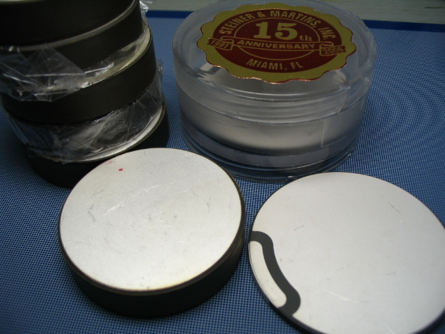

          Well I think you are right, the elements I have bought from them are now not on there website, you need 200khz elements (look at the foto). You can mail them ....
          I have also bought some 45 khz elements, with those I like to make a sounder/receiver that works only with audio detection. The receive signal into a sort bat detector system so you can hear the back coming signal. This way large Iron wracks can be detected at long rance. Working with a wesmar sonar you can hear wrecks on the audio output at the same time you see them at the display. Well the batdetector is working ok; summer evening, lazy chair, cold drink, listening to bats.....

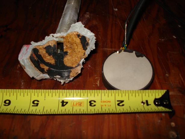

                    Thanks for the link Rickard. I'll search through and see if I can find the info you reference. The main campus of UNB is about 30 miles from where I live and my son is enrolled in engineering there! I have dismantled a few old commercial transducers and noted the cork behind and around the circumference of the elements. It looks like it plays an important role in the functioning of a transducer.

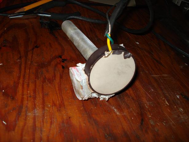

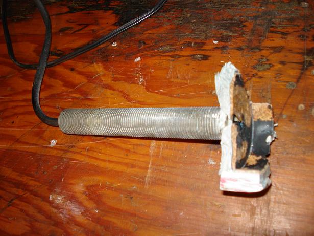

                          Hi Ap. The transducers wern't sidescan arrays, just through hull transducers for fish finders. I have the parts of one of them if you are still interested I can take a few pictures and post them.
                            transducer pictures
                            Here are a few pictures of one of the transducers I took apart. It was old in the mid 80's when it was given to me but they haven't changed much. The cork is about 2mm thick and the Piezo is 51mm diameter and 10mm thick. The window was some sort of black plastic 2m thick (not pictured). The window didn't appear to be glued to the Piezo?

                              Thanks Dave for the foto's, it is looks not so hard to make, the transducer looks mutch at the one's I had bought from STEMiNC.
