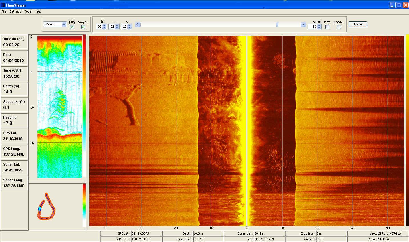

Hi Rickard,
Thanks very much for your reply. I have purchased a 998C SI, and built myself a towfish. The scan images seem very good considering the price!!
I have a transducer mounted on the hull, as well as a home-built towfish for deeper water using a 30 foot extension cable. The Hull mounted transducer can see about 45 metres to each side in salt water - which is great!
I purchased a thru hull transducer for the towfish and am experimenting with it. Looking around for a suitable cable to get down a bit deeper. will keep an eye on ebay.
Attached is a scan of a wreck in the local gulf, using the hull mounted transducer. The shadows on the right side have been resolved by moving the transducer nearer to the middle of the boat.
