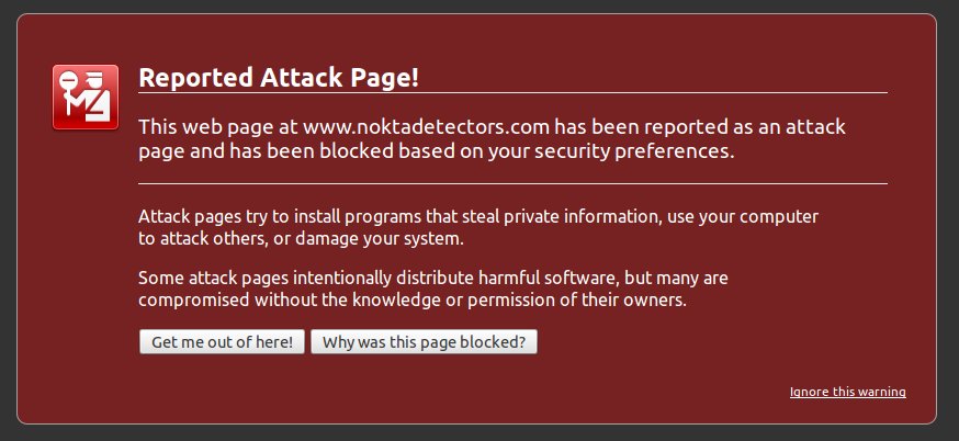

        Be careful with this site. Firefox displays this image:
          sorry about that, IE did not give me a warning, would a mod please remove link and post the spec below in my first post,
