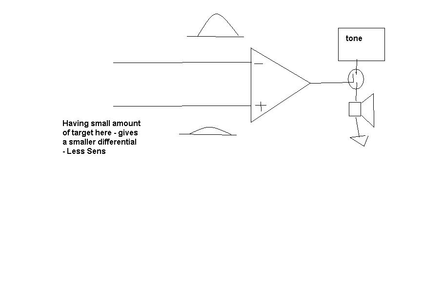

In this case the Target residual on the lower input (geb) will reduce the differential gain.
Or Sens to a target.
So, why have a filter on GEB ch which is centered to pass 9Hz Target residuals - which reduce Sens?
