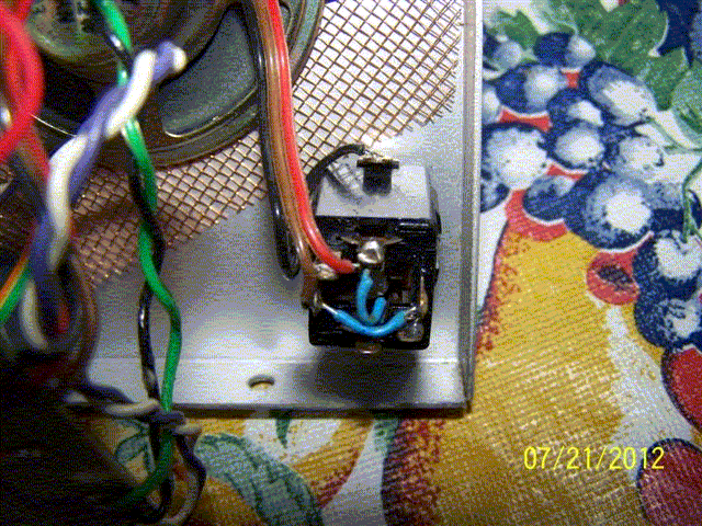

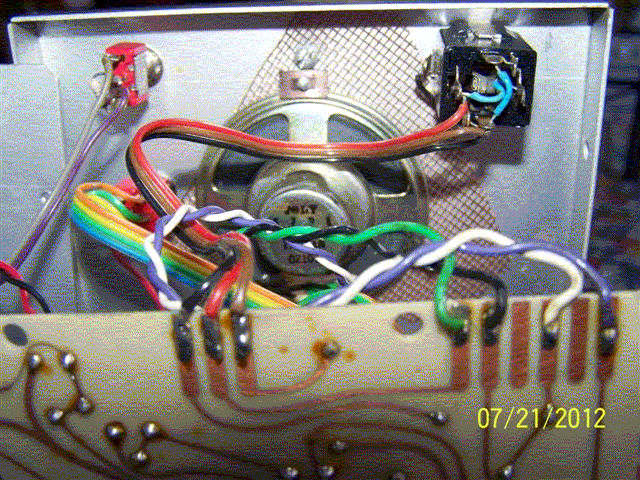

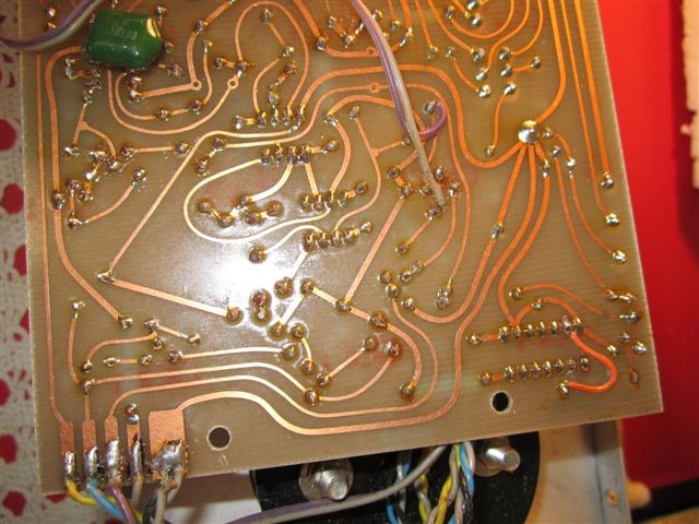

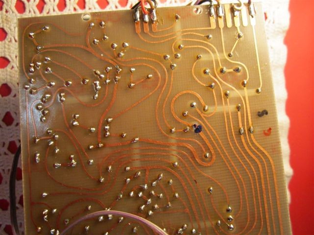

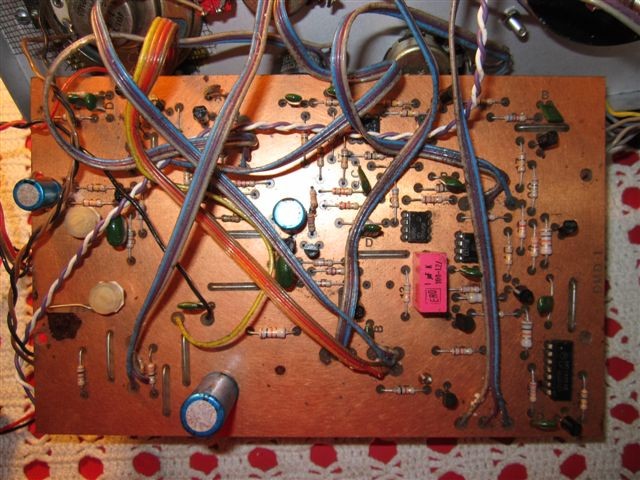

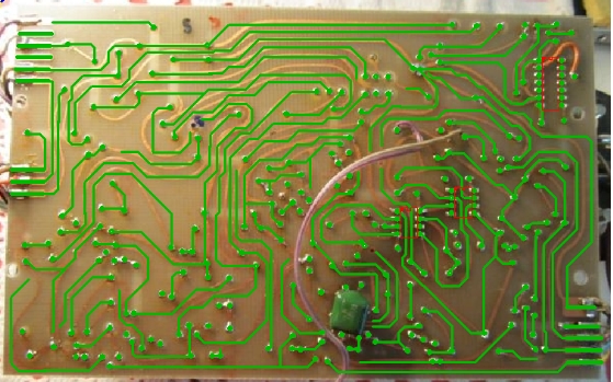

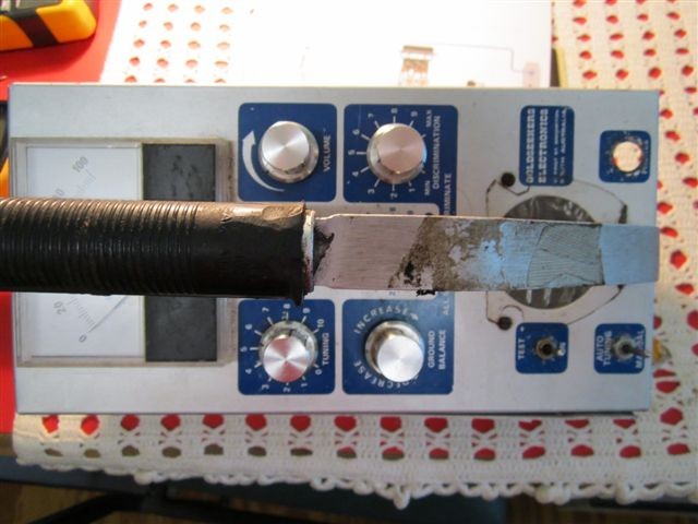

Hello to all has anyone seen this First Minelab Made in South Australia it came out when they started before the Goldseeker 15000 Model.I got it going by replacing I.C-4024 and Transistor A13 is a really easy circuit to work with but has a lot of wires all over the placegoing to the different pots and switches the wiring to the Headphone Jack was changed (I think) or the three on the board are not correct original since it was look by someone before it's the (Brown) (Red) (Black) at the top of second pic or left of 4th pic.If someone has this model in original wiring state and they could do pics like mine or tell how this three wires color wise go in the board and show a pic of the Jack wiring to make sure 100 percent how it was would be Great
It works fine Ground Balance really good picks up 1 gram alluvial Gold no problems with VLF no movement Discriminates iron nails etc O.k but when you plug the Headphone it uses stereo ones it shorts and does not work.Wiring as a said on the Jack or wiring on the board must be out.Before investigating any further I want to see if any one has this model to compare.Cheers for any help
