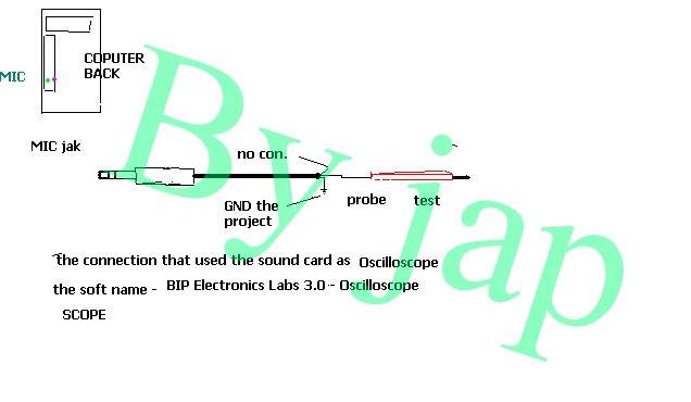

    Got one already, but It can't become portable, and laptop becomes electrically floating device by simple unplugging it from the mains adapter. Can't beat that.
    To turn it into an oscilloscope you'll need a good 3.5mm cable with stereo jacks on both ends, cut it in half, and use the wires to make probes, OR, you can buy real probes and BNC plugs to fit onto a cable with 3.5mm jack, or something else in that sense. You'll have to calibrate the whole shebang anyway.
    Download Visual analyser at http://www.sillanumsoft.org/ and get friendly with it ... that's it.

        Hi RelicHunter88 & Davor
        the connection.

                              Sound Card Update
                              The suggested Sound Card is unknown here...
                              I search and i found this one:
                              http://www.multirama.gr/products/pro...6&catid=021000
                              And this one:
                              http://www.kotsovolos.gr/site/produc...catid=10101226
                              This is Asus Xonar DG 5.1, not the Xonar DS that was suggested.
                              (Asus website: http://www.asus.com/Multimedia/Audio...specifications )
                              Sound cards have dissappeared from the local market... Strange...
