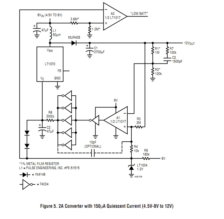

              What about this boost converter:
              2A Converter with 150µA Quiescent Current (4.5V-8V to 12V)
              http://cds.linear.com/docs/Application%20Note/an29.pdf page 9

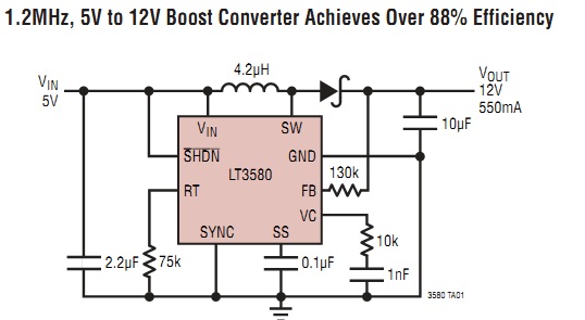

                  It is supposed to supply an IGSL board, so it will need less than 200mA in peaks. Guess most of our toys are of the same appetite, so 2A is an overkill. Mustafa's circuit is nice, but I'm not sure how to sync it with my gear. In fact, due to the low power consumption a SEPIC solution with LM5001 could do just fine. Carl, if the circuit you mention is not a problem to share, please do :wink-nudge:

                    LT3580 is similar to LM5001.
                    Pin 5 Shutdown/undervoltage lockout
                    Pin 8 SYNC

                      I believe I used one of the TI apps circuit straight out of the data sheet. There are better buck-boost solutions, but they don't have a sync pin. And there are better sync'd boost regs, but they don't do buck-boost.
