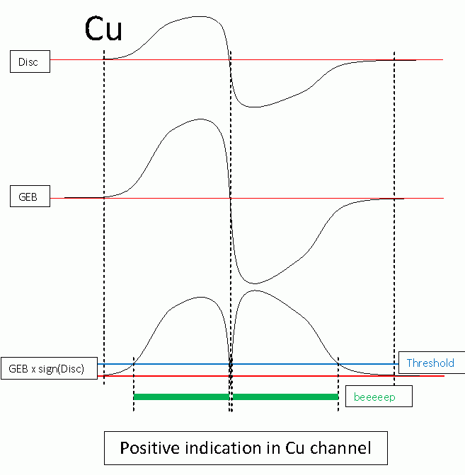

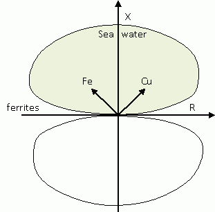

    Let's observe a non-Fe channel of a regular 2 quadrant Rx.
    We have a GEB channel that has a zero response for ground vector and a positive response for all metals - considering a positive coil phase.
    We have also a Disc channel which has a response ~perpendicular to the GEB. It will have response positive for some metals and negative for others.
    They both go to the comparators to be tested against a threshold value, and these form an analog AND function. If both Geb and Disc values are above the threshold, a Geb value is passed through, and detector beeps.
    It is important to notice here that it is not necessary that Disc channel passes the threshold to obtain a correct response, but instead it must be positive. In a blurry area between a zero and a threshold value, it is the GEB that must overcome a threshold for a clear response.
    To obtain a 4 quadrant Rx we need an analog XOR function, and in practice it is a balanced mixer or a 4 quadrant multiplier. There is a slight problem with both - with Disc and Geb being of the same order of magnitude, the output would be squared, unless... Disc is made binary.
    So when Disc is positive the output of such XOR would be equal Geb, and when Disc is negative the output would be -Geb.
    Easy way to make this is to supply Disc to a comparator and compare its value with zero. The comparator binary output is supplied to a switch which choses between a Geb and inverted Geb. Such signal is further compared with a threshold value, and passed to the tone circuitry. And we have a solution for discrimination of the opposite quadrants for a non-Fe channel in a 4 quadrant solution. It may even be done as a hardware add-on for the existing rigs.

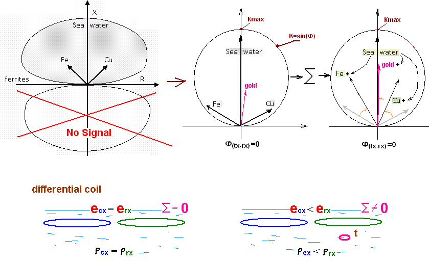

      you have 2 quadrant RX and 2 quadrant CX… no 4 quadrant (pic)

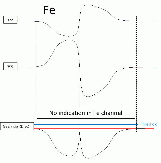

        So here goes the visual representation of the example above, yet with addition of what happens in Fe channel as well. Input signal is considered to originate from a differential coil...

            Actually target + here means a positive phase of a differentiated response after the demodulating switchers. I'm talking about the demodulated signal in a frequency range ~10Hz.
            So this is not about target + and ground -. It all happens at earlier stages. Ground signal is either canceled or not, but in both cases I assume it doesn't produce response in a demodulated and motion compensated differentiated GEB channel due to the demodulating switcher being driven by a 90° shifted signal.
            This topic is about making sense of a signal that may have phase reversal due to the use of a differential coil.

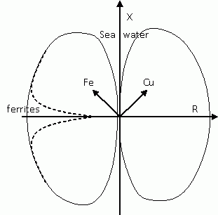

                      I'll give an overview of what I want in a few posts to make it easier to follow. First is the "classic" VLF constellation, without the discrimination angles, say an "all metal" response. It is typically used for target response level. In 2-quadrant Rx only the greenish lobe is used:
                        If I got it right, and I'm sure Sergey will correct me if I'm wrong, his Verator uses the following tone extraction scheme which uses a Disc signal (the lobes) and punches an additional hole in the left lobe (dashed line) for suppression of the reactive ground signal. IMHO just brilliant! It makes Verator a perfect rig for beach combing.
                          So, you can observe the channel that produces a tone as a masking function - it masks ground signal. In classic solutions it masks ferrite-like responses, in Verator it primarily masks high R responses like those of the sea water and additionally it punches a hole in ferrite-like response angle to make it just perfect. Verator does that by means of a VCA (2-quadrant multiplier) produced as a PWM controlled switched capacitor attenuator (phew!).

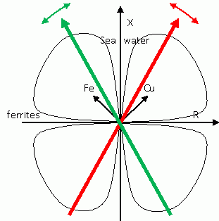

                          What I want to achieve is a tone response mask as a separate function from phase discrimination vectors. Thus I'd have ground responses at bay regardless of my discrimination settings. It means that my Fe and Cu tones may overlap, but the sea water response will be attenuated anyway. A perfect beach analyser! With 4-quadrant discriminator and a differential coil it will eat the existing PI toys on their own terrain.
                          The mask I'm talking about is a clover-like with 4 deep holes fixed at ferrites and sea water. Discrimination vectors may be set freely and independently (red and green).
                          To obtain that clover-like mask I'll need a real analogue multiplier. It is produced by multiplication of two channels at angle.

                                In my analysis of Verator rig I concluded that the signal produced by the X path is the one with left and right lobes since it is switched in phase with Tx, and that would produce a nice pair of holes at the sea water vector. So in any case and regardless of the differential coil it would outperform nowadays VLF detectors on the beaches. Even more so with the differential coil. The "No Signal" part of the mask I indicated as white in order to emphasize that I'll use it in a 4-quadrant solution.
                                Otherwise we are on the same track. However complex to follow, a Verator design is a very nice and unique rig.
