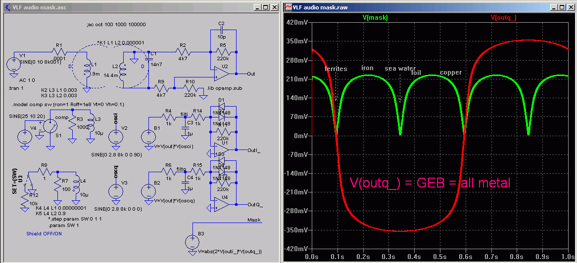

            So here is the thing. The schematic is the reused small project I used for qualitative research on coil shielding, and I needed a phase-wise response of a system over full 360° range. The easiest way to do that is using the oscillators 1Hz apart and setting transient time at 1s. Easy.
            The legend on the picture is just for indication purposes, and not explaining what happens in the circuit. The very circuit gives the response of a piece of Al foil (L/R=10u) and i use it here simply because of the null close to the zero time on the diagram. So in fact everything has to be shifted a bit to the left.
            This picture shows only the 2 quadrant part for brevity, but in 4 quadrant it is just duplicated. Mask does not stop beyond copper.
            Sure, notch sharpness depends on the signal amplitude, and it can be optimised for, say inch above sea surface.

                        So I wanted to have some nice audio masking function that would provide me with both classic GEB that cancels ferrites, plus another notch that would cancel salts. These are ~90° apart. In addition to this mask, I'd have one (like IDX) or more discrimination channels working in TRUE/FALSE way to establish 4-quadrant discrimination criteria. Tone is produced as TRUExMASKxCARRIER, where MASK is a level obtained from the audio masking function, and CARRIER is an arbitrary audible tone, say output from 555 or better.
                        My first idea was using analogue multiplication where a=GEB and b=Disc and Disc is ~90° from GEB. However, ab is not the best choice because a~b -> ab~a^2 hence for the small target response the multiplier response is ever so smaller. At Wolfram Alpha it is presented in 2D as this:

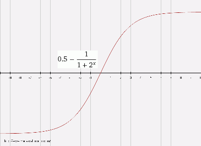

                        A step forward is providing some compression to account for huge span of signal levels received from targets. A simple approach is using a limiter with antiparallel diodes, and it's transfer function would be like this:
