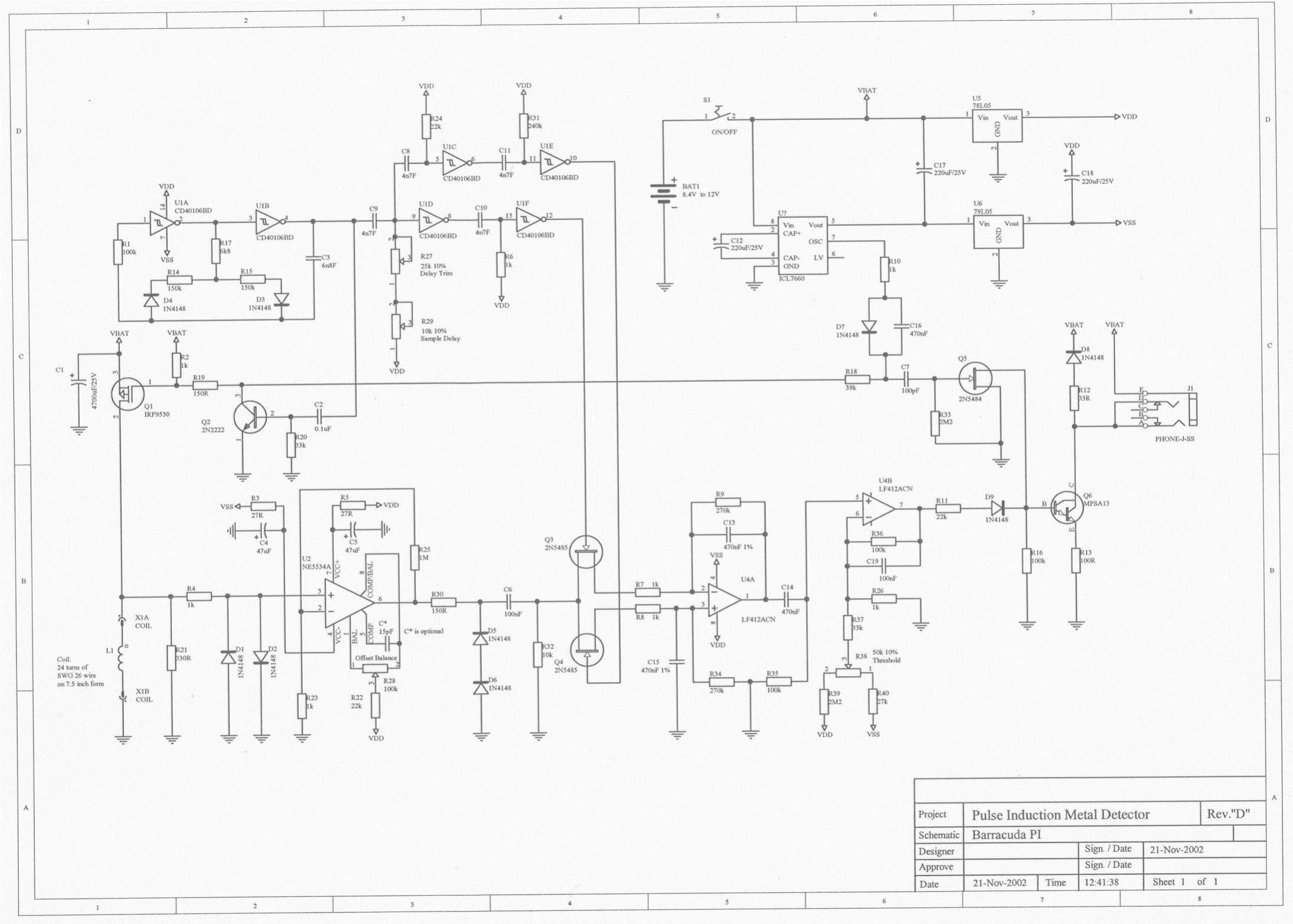

        Hi
        Am I right thinking that the ICL7660CPAZ is ok to use as long as that 10v is not exceeded because looking at the spec sheets everything else is the same.
        So the machine could either be used with 12V supply regulated down to 10v or run on a 9v supply.
        Can anyone see of any problems with that please.
        Dave

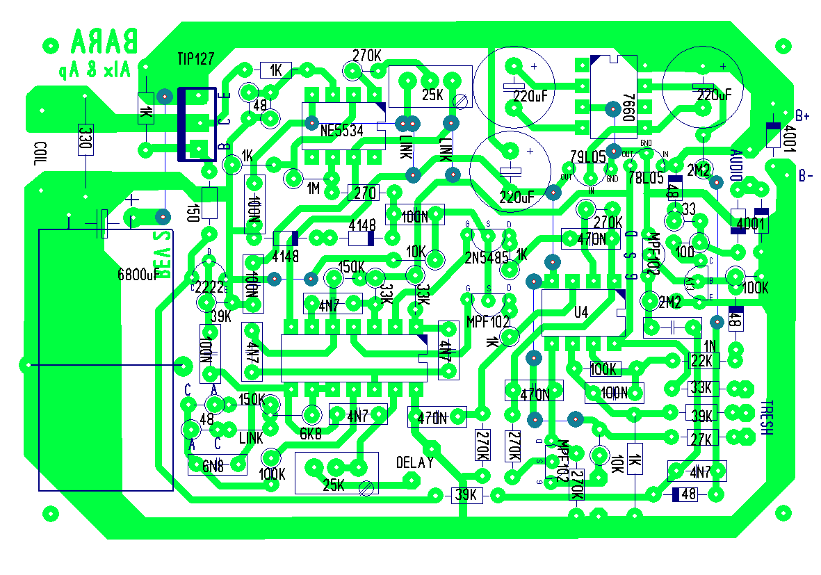

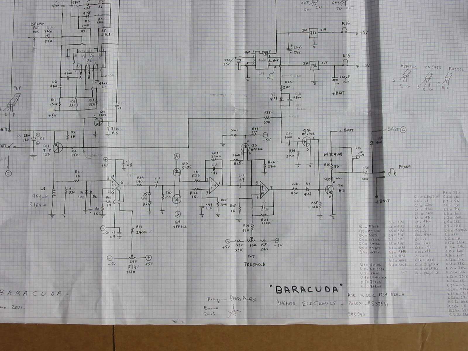

          Hi
          Building off the layfiles that were kindly designed and then posted on here together with hand drawn circuit and taking note of the component part numbers and circuit ident seems to be plain sailing at the moment and like to say a big thankyou in advance.
          The only thing im stumped on is where is the Sense pot that im led to believe was on the original Barracuda because for the life of me cannot see it listed anywhere.
          Will post some pics soon of how its progressed
          Warm regards
          Dave
            as far as i know dave the pots on the original barra were threshold and delay in the rev2 board the delay pot is excluded and bridged as really once its set at the cemet pot to detect gold it does'nt need adjusting only very rarely i reinstated this pot on mine the two points on the board next to the delay cemet pot go one to pos1 and the other goes to wiper the same pot as threshold is fine
            thanks ally x
              Thanks for the imformation Sinclair
              I had my doubts because in the Andy Sabisch report he stated there were two external pots which were on/off sense, plus threshold, so theres me looking for something that isnt there.
              Thanks again
              Dave
                Almost done just waiting for the 25k presets once there installed shall solder the fly leads that go to various pots etc then clean and trim the PCB
                  Can anyone tell me was the original Barracuda designed to work on 9v or 12v please ?
                    Looks like a Range.
                      Thanks Homefire
                      Thats good actually if the data is correct on the revised circuit, because by the looks of the orignal picture here of battery cells looks like a 12v pack thats able to drop to 8.4v and still operate.
                      The minipulse anything below 1v drop off becomes unstable hense the cut off point that tells you to recharge battery.

                            I think the original Barracuda has 8x1.2V=9.6V, and stability is lost below 7.5V. I put 22K (I have not added 3K).

                              Thanks Maikl
                              Of course they are rechargeable hense the 9.6v, thats what im going to stick to, want everything as original as possible for my field experiments then can do mods if or when needed, thats good news thanks.
                              Maikl maybe you can answer this one that I asked earlier, Now we know that im going to be using maximum supply voltage of 9.6V, can you see any problem me using for U3 a 7660 instead of the 7660A.
                              Ive read the spec sheet till im blue in the face and cant see any difference at all apart from the supply voltage, unless im missing something.
                              Theres a good possibilty that the original used the 7760 because these machines had know access to install dry cells so the max supply could never have been over 10V.
                              If everybody here is not sure im going to try anyway and will post my findings in due course for fucture reference.
                              Dave
                                Hi satdaveuk.
                                You're probably already bought 7660 (max 10V), that will probably work. Maybe it's better if you bought 7660A... (max 13V), it is better to leave some reserves.
                                Is the original 7660? It is not known with certainty, tags are deleted, but it is not so important (except for the power supply).
                                It is important that what is said Alexismex: Q1=TIP127 and coil L=453uH R=1R5 (fast coil - similar coils Chemelec)
                                Otherwise, there are substitutes for 7660:
                                -3 times more expensive LT1054 (max 15V)
                                -2 times more expensive ICL7662 (max 20V)...
