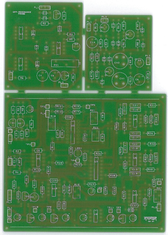

        • PCB's for Projects in "The Book"
          I have some PCB's for the IB,BFO and Probe projects
          All 3 for just £8 + shipping
          Kits will follow shortly

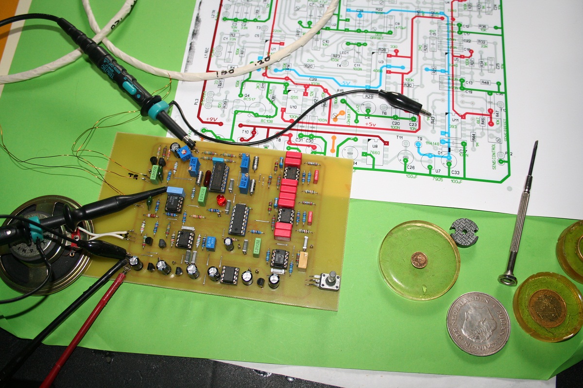

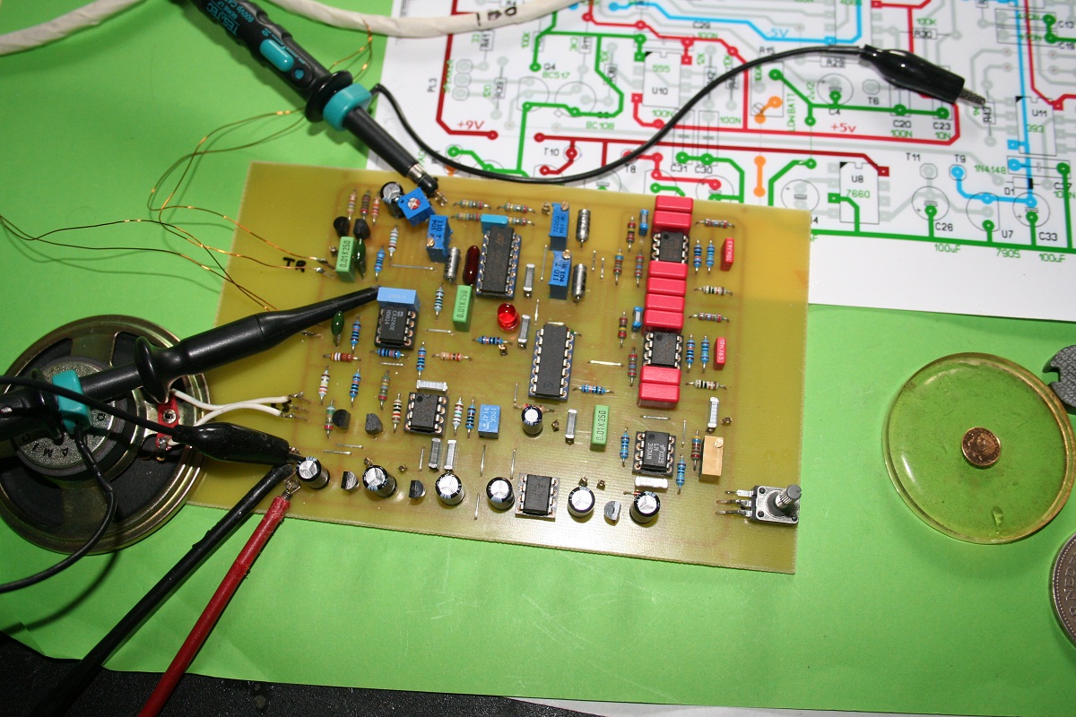

                • raptor
                  Finished the Raptor, it looks it is working nice, not tested outdoars so do not know how well it is in the real world.. some photo'sClick image for larger version
                  Hope George (Qiaozhi) can tell if the scope shot are correct... I am not much a reader, I know it is all written in the book.. I think...
                  Best regards.
                  Ap
                  • pcbClick image for larger version

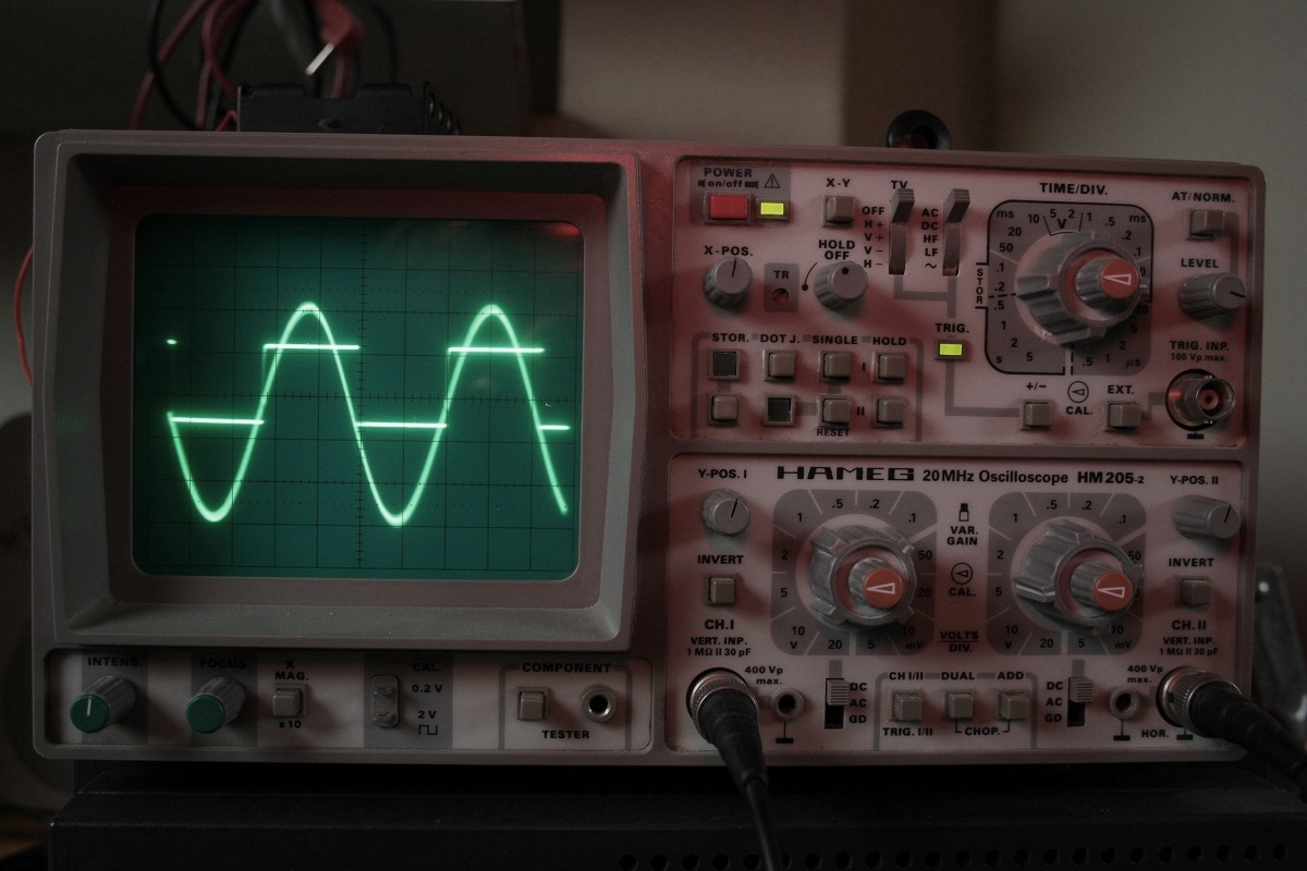

                    • Scope settings correct ? receive signal : chan1 - tp 3
                      disc preset : chan2 - tp 2

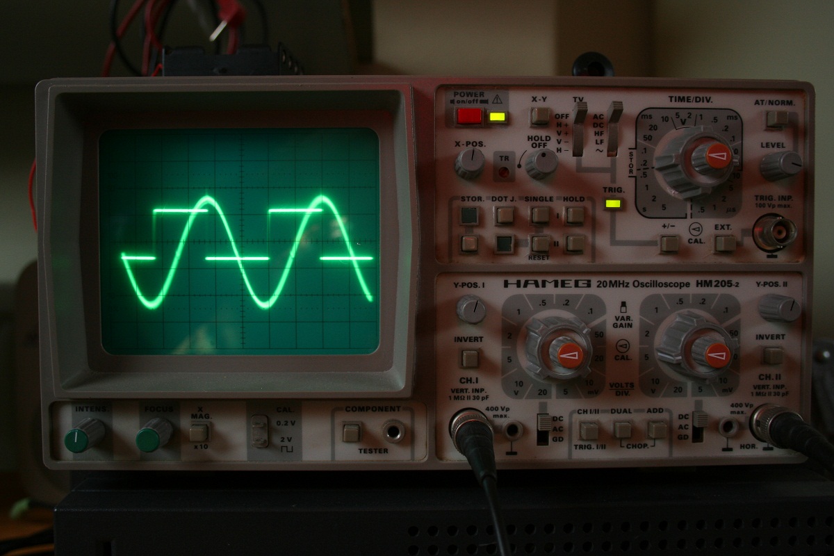

                      • gound preset ok ??
                        chan 1 receive signal tp3
                        chan 2 geb preset tp5

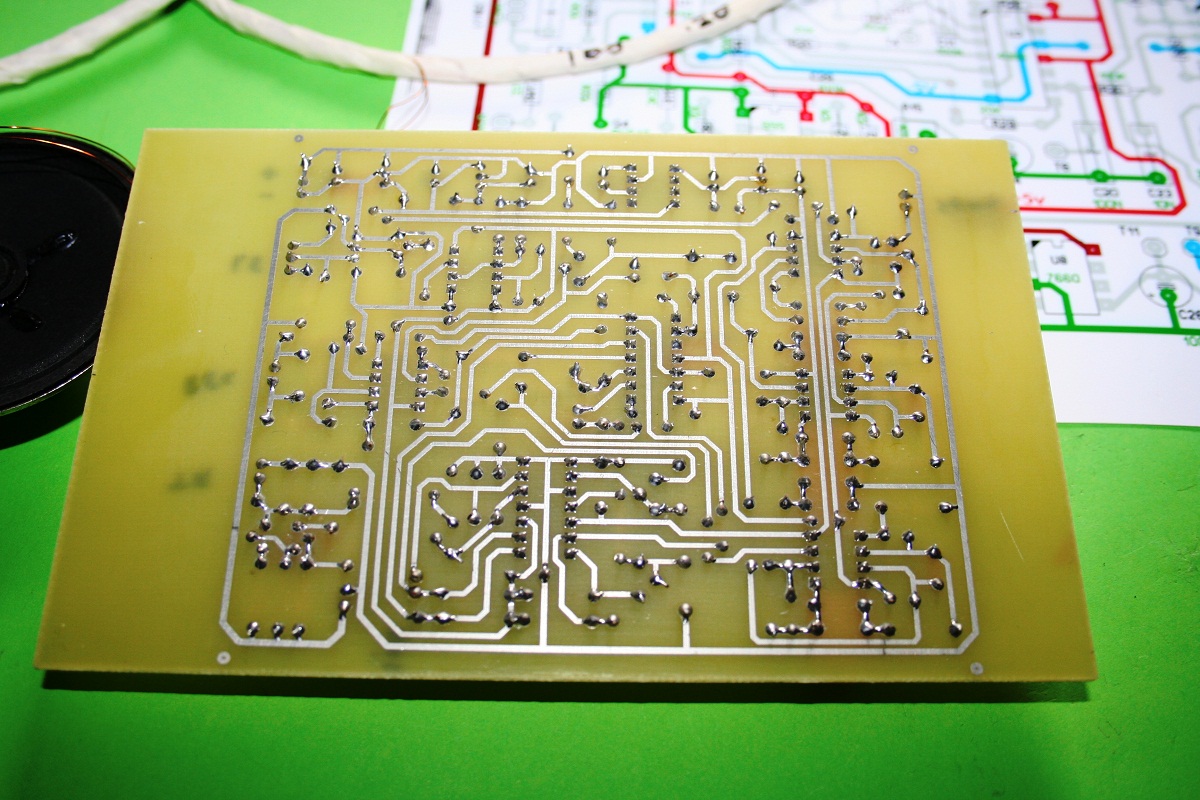

                        • parts...if anyone spots a error please tell Click image for larger version
                          • Originally posted by ApBerg View Post
                            Best regards.
                            Ap
                            Hi Ap,
                            Looking good! Well done ... you are the first to complete the Raptor design.
                            The scope shots all look as expected.
                            Are you using a commercial Tesoro coil (as recommended) or your own homemade coil?
                              Hi Ap,
                              Not used a commercial coil, used a diy coil Ivica style , on the photo you can see them at the top. No screen just for testing.
                              You can also see the items I used for testing, the ferrite core is gone while the large silver coin is still detected .
                              Good sens. for the gold ring and euro ! Think it is a good project !
                              Best regards.
                              Ap
                                Best regards.
                                Ap
                                Excellent work.
                                Please let us know how the field testing goes.
