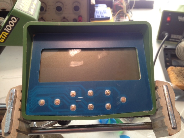

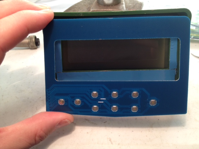

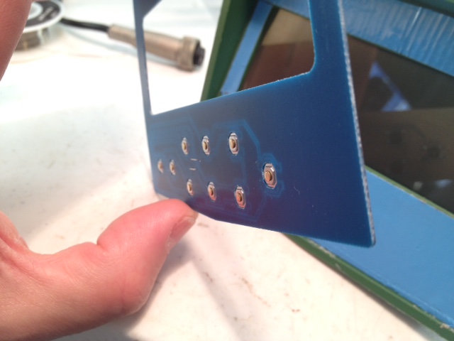

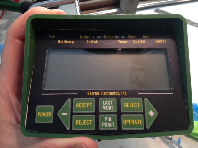

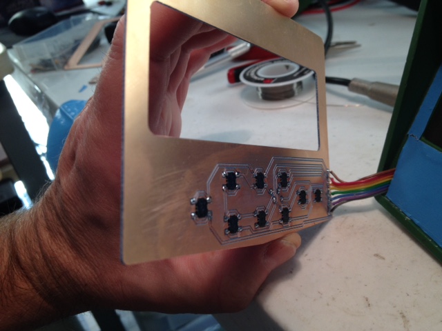

        It's finally complete! After the superglue disaster, I made a new PCB and ordered new switches. I finally had time to assemble and install the new keypad today. It works very well. The switches have a nice feeling when they are pressed. You know when they are actuated. Just need to test in the field now. Maybe tomorrow morning if not too cold. I used double-sided carpet tape to secure the PCB to the chassis and also to attach the original faceplate to the new keypad PCB. Here are a few pictures.

          Great work, now it should last forever!
          If some of my MD keypads should make trouble I will also go for such kind of real reliable solution.
          Double-sided carpet tape can be extremly sticky and for smaller stuff those double sided little white
          sqares to attach photos in albums also do well.
            Excellent job, and much better than my solution.
