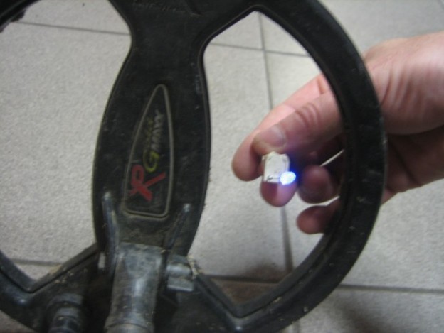

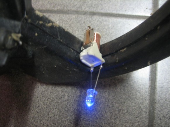

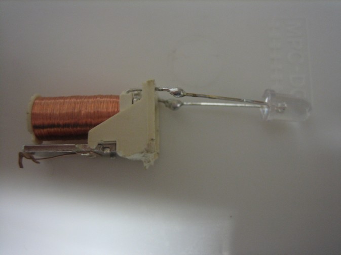

                      A very simple test for wireless energy transfer from the MD coil - in the opposite way of the concept of a wireless charger:
                      - take a small coil from a 12V/5V relay
                      - solder a high-bright LED to the coil terminals - polarity doesn't matter
                      - keep the coil in the vicinity of your MD"s coil
                      In case of my XP Goldmaxx Power, the right coil is clearly the TX side.
                      You could of course use this as extra illumination on a dark field...
