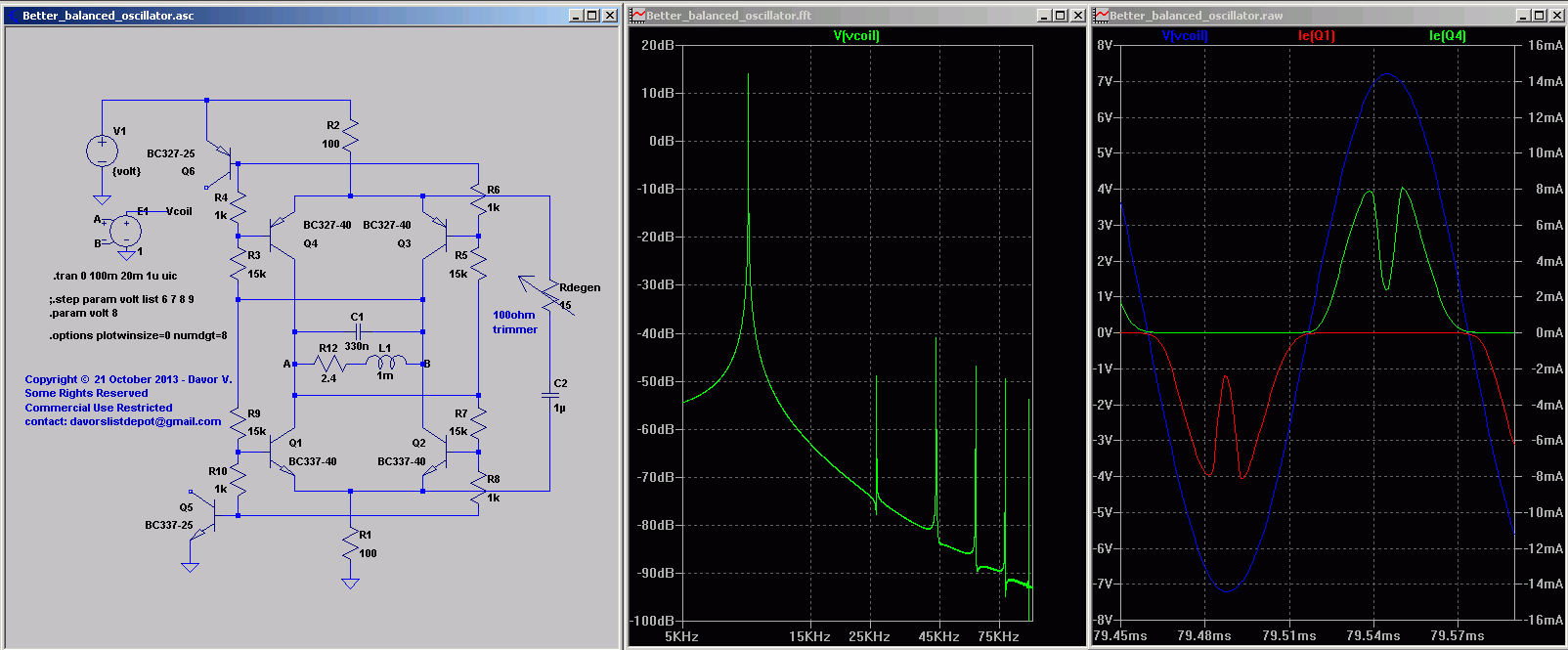

                        • I have an update. For some time now I'm examining oscillators that turn from AB class to C class operation once they reach oscillation. I realised that if duty cycle is just below 50:50 split, some real magic happen. Results are reduced harmonics and reduced power consumption.
                          So this is my latest balanced oscillator. There are a few odd details aimed to retaining stability over larger power supply span and with a simple compensation adjust to accommodate for component tolerances and transistors gains. Most probably it could be refined, but I'm quite happy with it as it is. 5th harmonic is the largest one, but quite low. Transistors Q5 and Q6 are used as diodes, hence open collectors. Rdegen is a trimmer that acts as emitter degeneration between PNP and NPN transistors, so in effect it provides controllable negative feedback.
                          Next up will be some simple phase shifter for GEB and Disc purposes that uses balanced input.
                          • Is there a reason for the use of the transistors for diodes? I find that interesting.
                            • Yes. The base-emitter PN barrier in transistors is doped more than regular diodes or base-collector, and thus have ~0.1V higher voltage drop. Reason for using this particular diode is that H-bridge transistors have near the same voltage drop and the whole contraption has decent operating conditions over much wider power supply voltages range. A transistor of the same family is a good match.
                              If you ever want a diode with a drop slightly lower than regular diodes, go for a JFET.
                              • Thanks, that's a nugget of Info I'll keep in mind.
