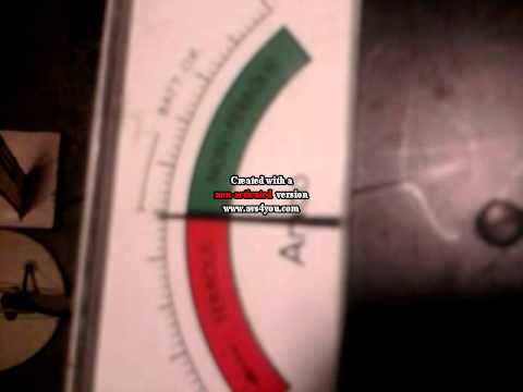

      Regard to the 'Arado 120b I will post, if you have patience, a bit' of photos since I do not have a video camera,
      in the case tell me if it's good for you; keep in mind that if you were to serve the variable capacitor
      with step decreased from 100 + 80 pF that I used to replace the original, I can let you have the capacitor at cost,
      about $ 15, but I do not know the expenses related to the postage.

        I think it would be great if Arado is seen on video because I believe it has something to show. Please see if your camera is capable of taking videos
          Ok Dave, I try to send you a video on Arado in action, this week end, but please tell me what you want to see.
          Blitzkrieg

              We'll come to that, let's see a video first. I think it is worth a shot.
                Hi Davor
                here is the video, I apologize for the low quality, but as I said I do not have a video camera so I used my son's cell phone .
