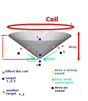

    Hi all,
    I just finished a Surf Pi (my first detector project), that I bought from Silverdog's shop and when testing it in air I have found that I get a consistently strong tone from 0 cm to about 15.5 or 16 cms with a 1 euro coin. Between 16 and 17 cm I get a weak tone and after 17cm absolutely nothing. I had assumed that the tone would reduce gradually as the coin moved further from the coil but it does not. It dies in a very short range between 16 and 17 cms. Can anyone tell me if this is normal for this kind of detector? (I built a flat spiral coil 32 turns about 120mm ID and 175mm OD with enameled 24AWG)

    Hi Freediver
    its normal, see photo i hope it help.
    best time
    j.
      Hey thanks for the diagram Jap, now I can start experimenting with different coil geometries.

          Freediver some of the early kits had the value of resistors R18 and R22 swapped did you get them in the correct holes ?
          the wrong values made quite a difference to the depth.
          I just did a quick test with my surf pi for you, my nicad pack is down to about 8 volts
          but with a simple 20cm round coil
          I can get a 1 euro coin made in Spain at about 25cm
          that's in the air only.
