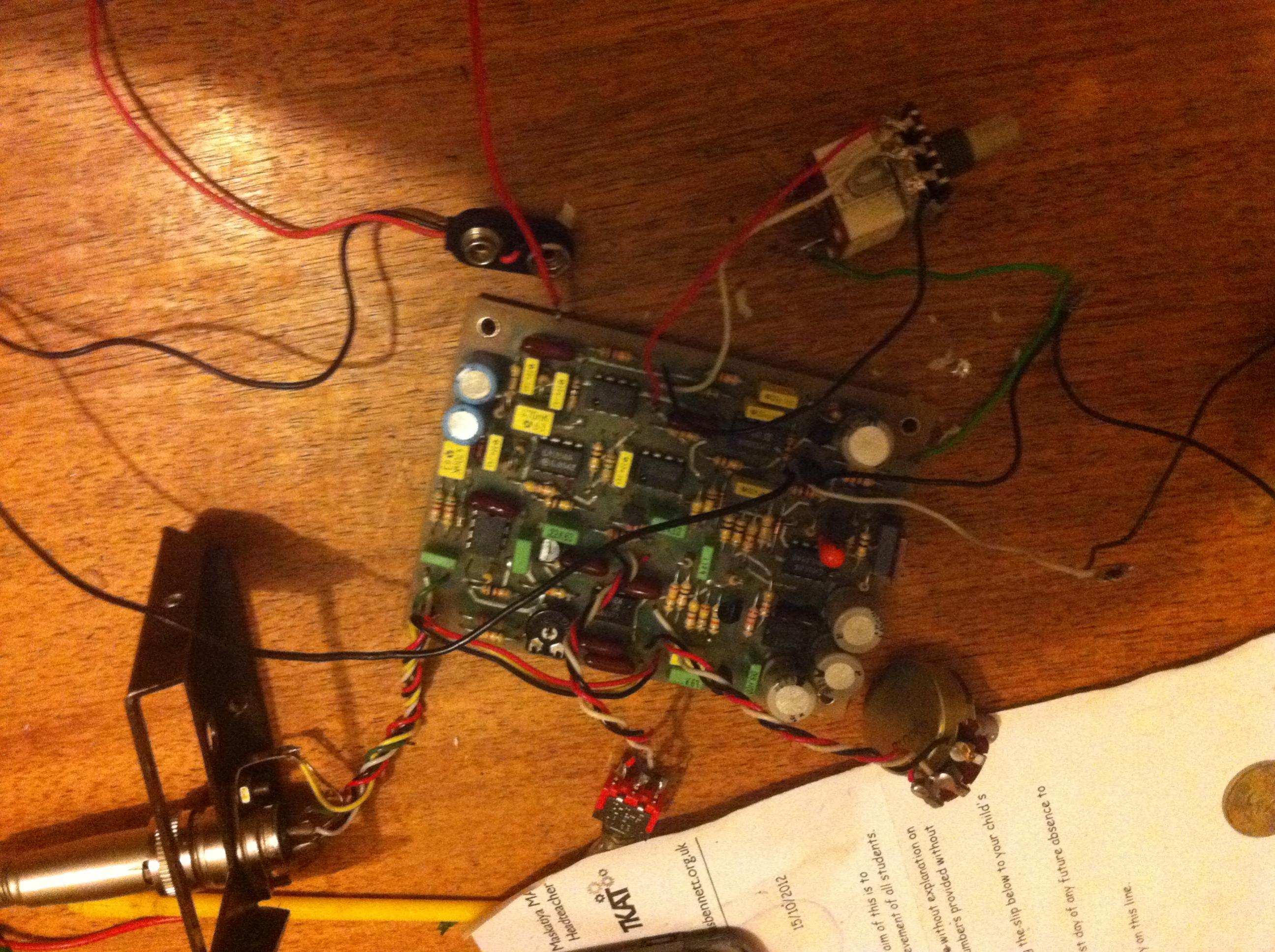

    all the componants have been checked im atempting to clean the bourd if unable to fix mabey i need to make a new bourd or get one from somewhere many thanks

      hi thanks for the help i sent it to pentechnics he said he checked the pots with a scope and everything was fine and he said there was nothing gone on the bourd and he said that the bourd was contaminated is there any thing i could do that you think might need changing im going to atempt to clean the bourd if im not sucesfull could you have a look at it for me and can they be modified im willing to pay thanks wendy
        I have a couple of mods, which add around 2 inches depth to the SSP, they cost pennies to add and I'll hapily do them FREE OF CHARGE. I'm no longer repairing detectors for profit, I do it for fun (I can afford to as I make my money in a far more lucrative market now).
        "Contaminated" board is a "standard" Tesoro fault (or so it would seem). That is NOT to detract from Dave's excellent capability, but I have repaired many machines he couldn't and vice versa no doubt, indeed (IMHO) there is no better repair service (paid for) ANYWHERE in europe than Pentechnic!!
        Be VERY careful of what you clean the board with, you could end up making it worse. BEFORE you do that though, have you tried a difrerent search head?

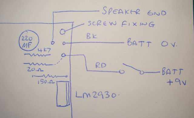

          it came back from daves the black and red wire which connects from the bourd to the battery terminals i spoke to him today and he said the black wire goes next to speaker wires and the red one goes to the corner of the bourd which i have done and it still doesnt work i cleaned the bourd with apl rubbing alcohol i dont know if it me or him can you advice or would you buy any chance have a mod bourd i could purchase and you can have the old bourd with pots many thanks

ID:	333706 is it possible you could tell me the wires from the sensitivity pot are in the right place i do not think soand would you know where the red battery wire goes
