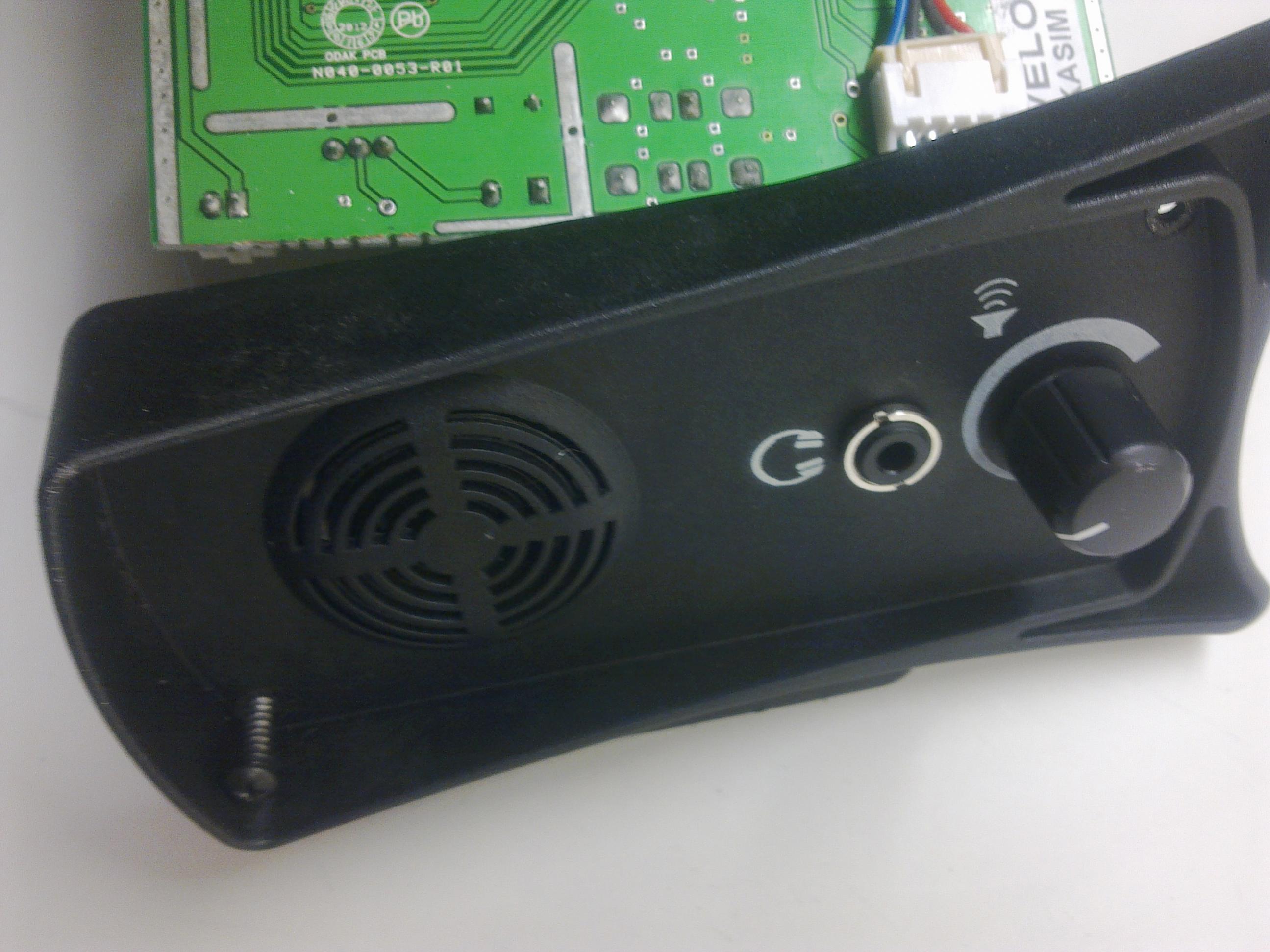

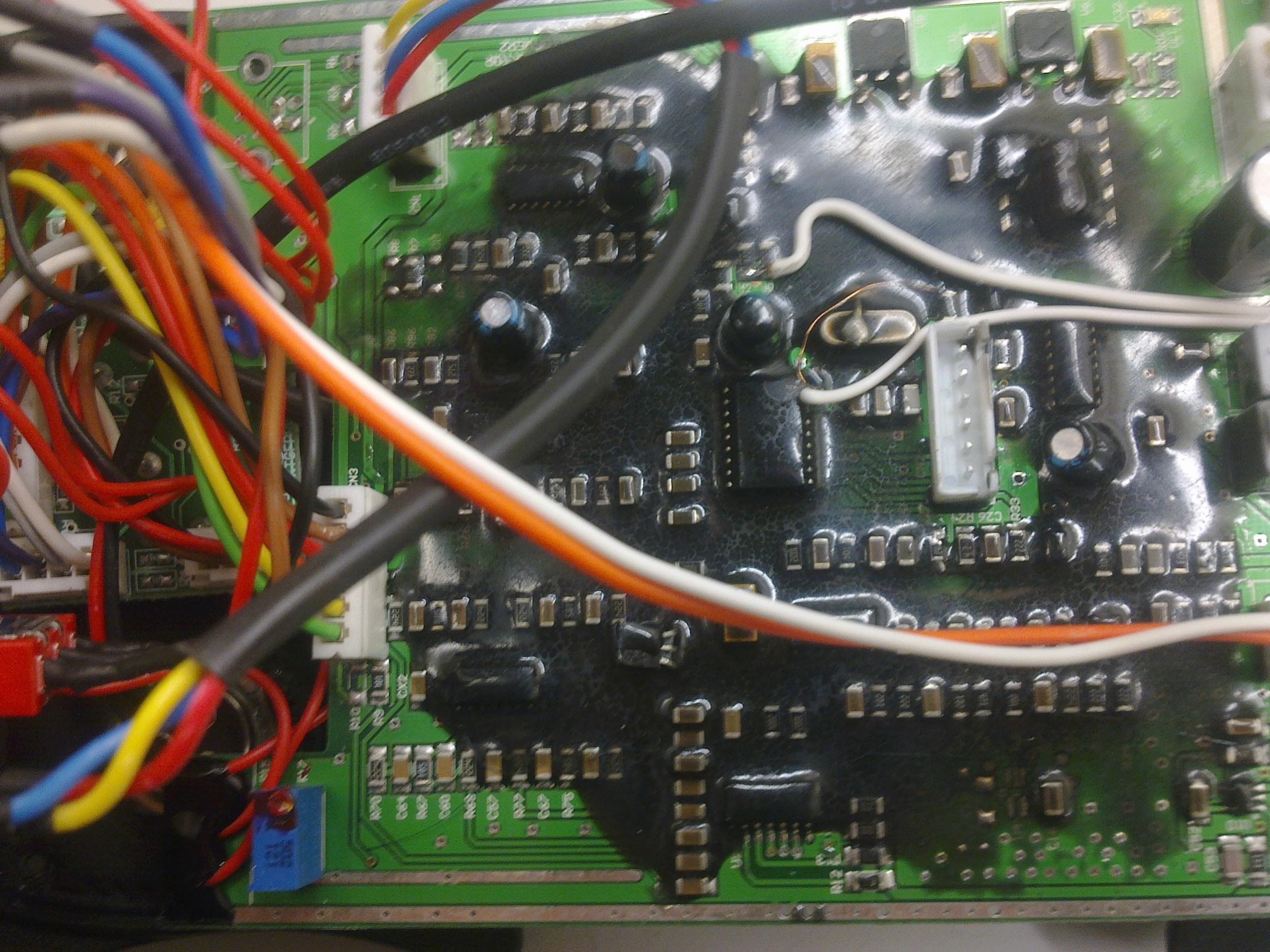

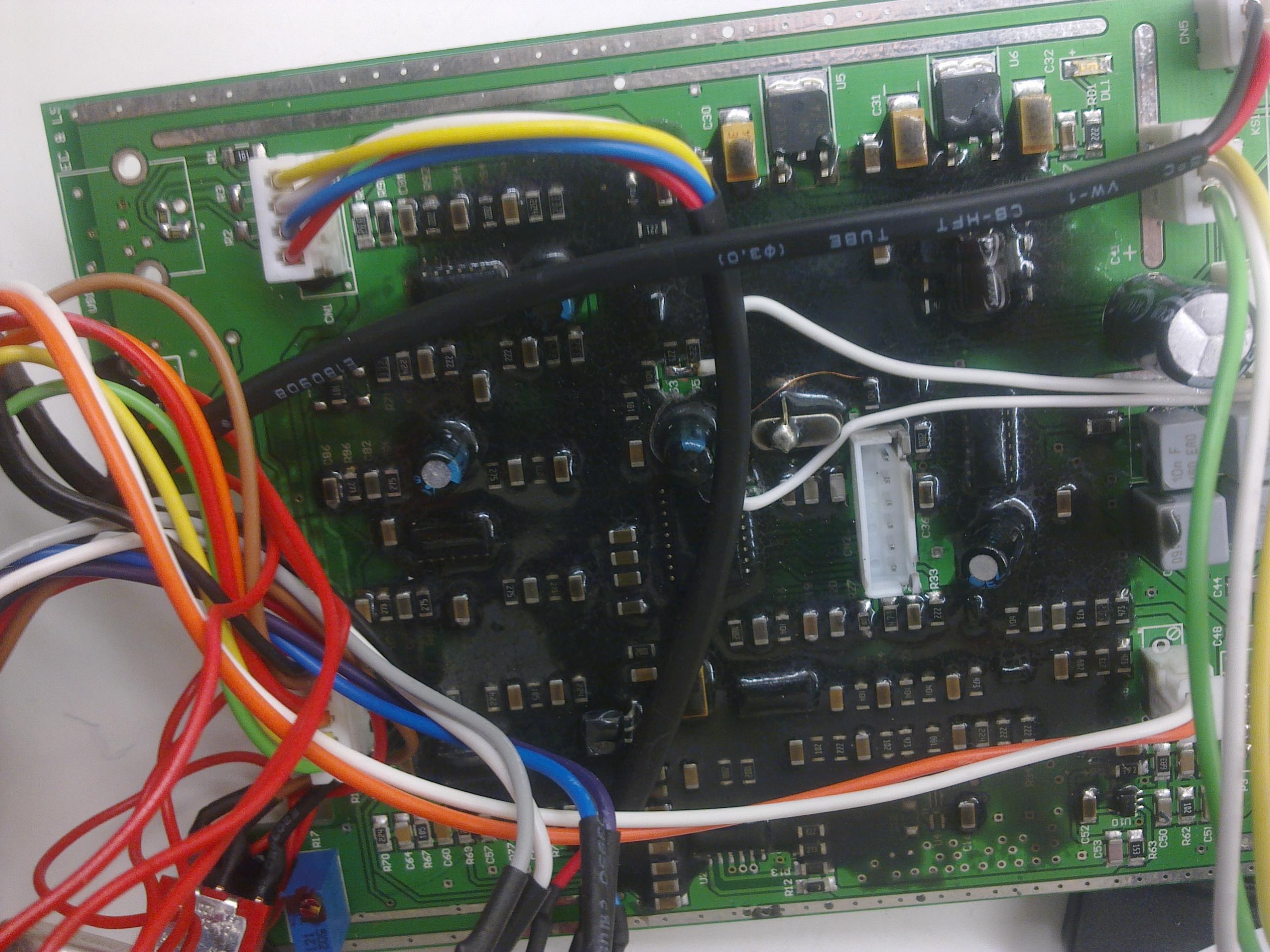

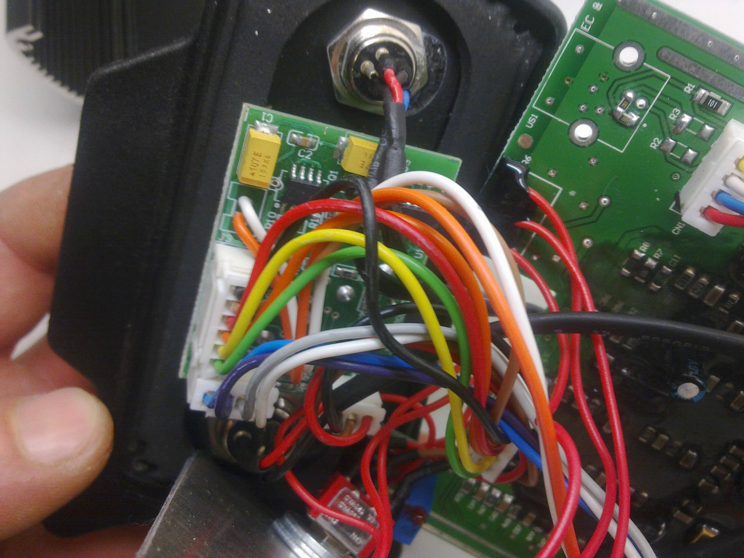

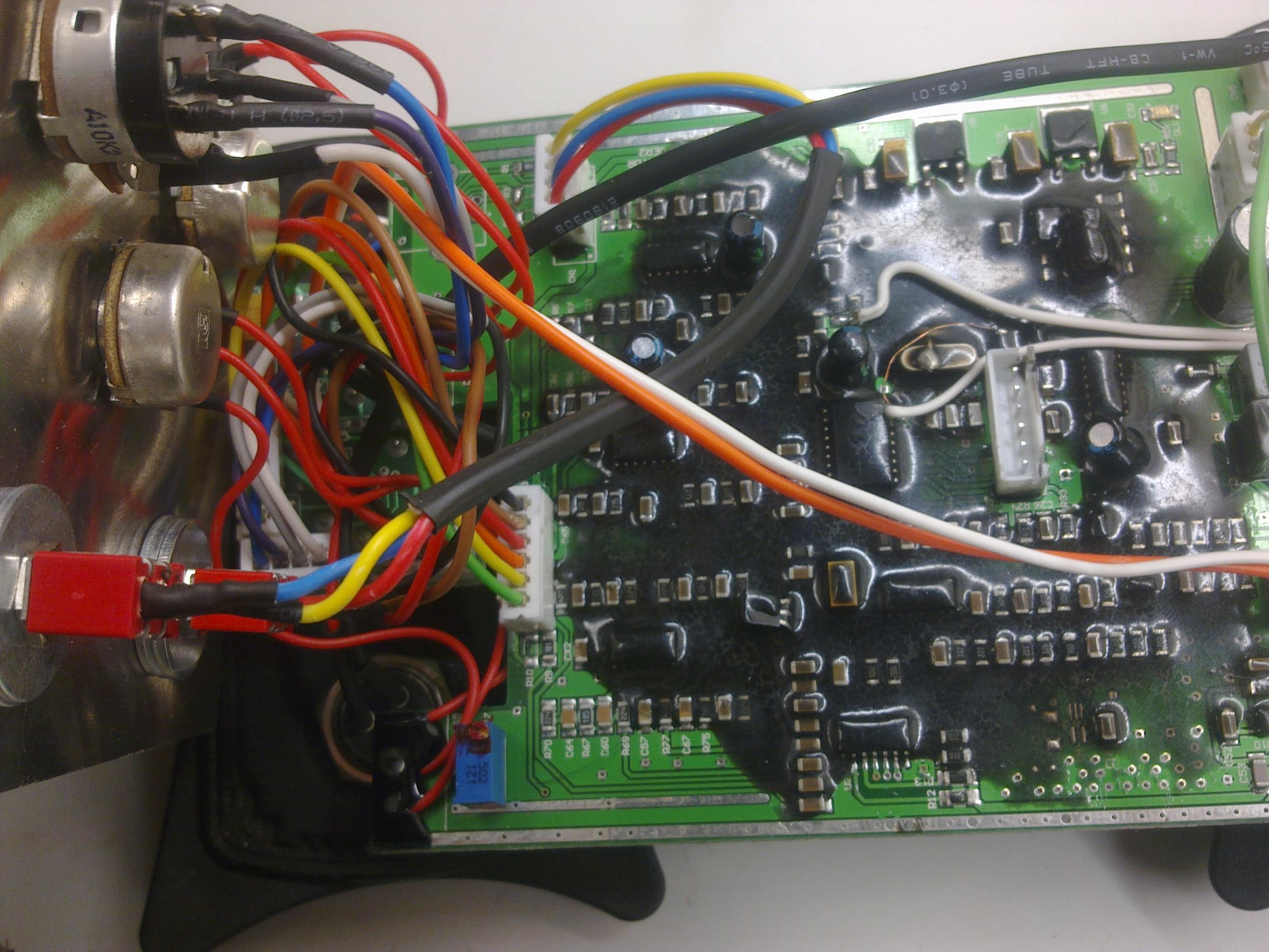

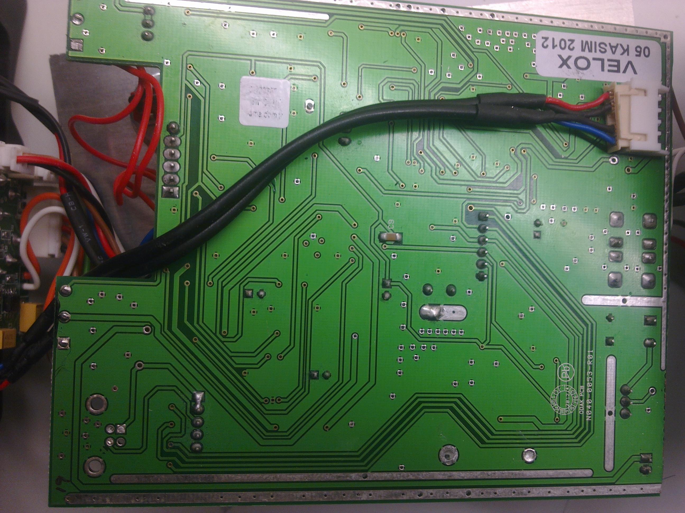

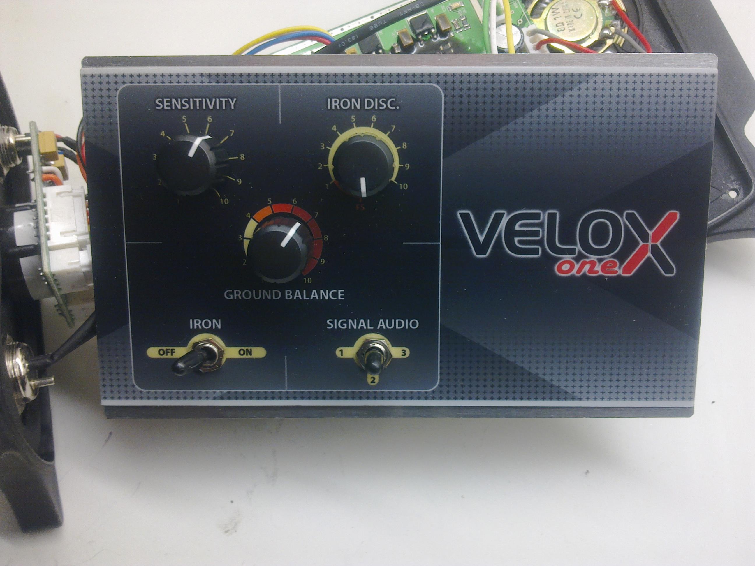

            I think it is pure copy of the Gold Maxx Power. Today I opened this team and I have taken the photos. The PCB is well done, but the components are deleted. Has a kind of resin components above. It's just as fast as the Gold Maxx Power, but the Gold Maxx Power I like more and is cheaper. Greetings. Eduardo.

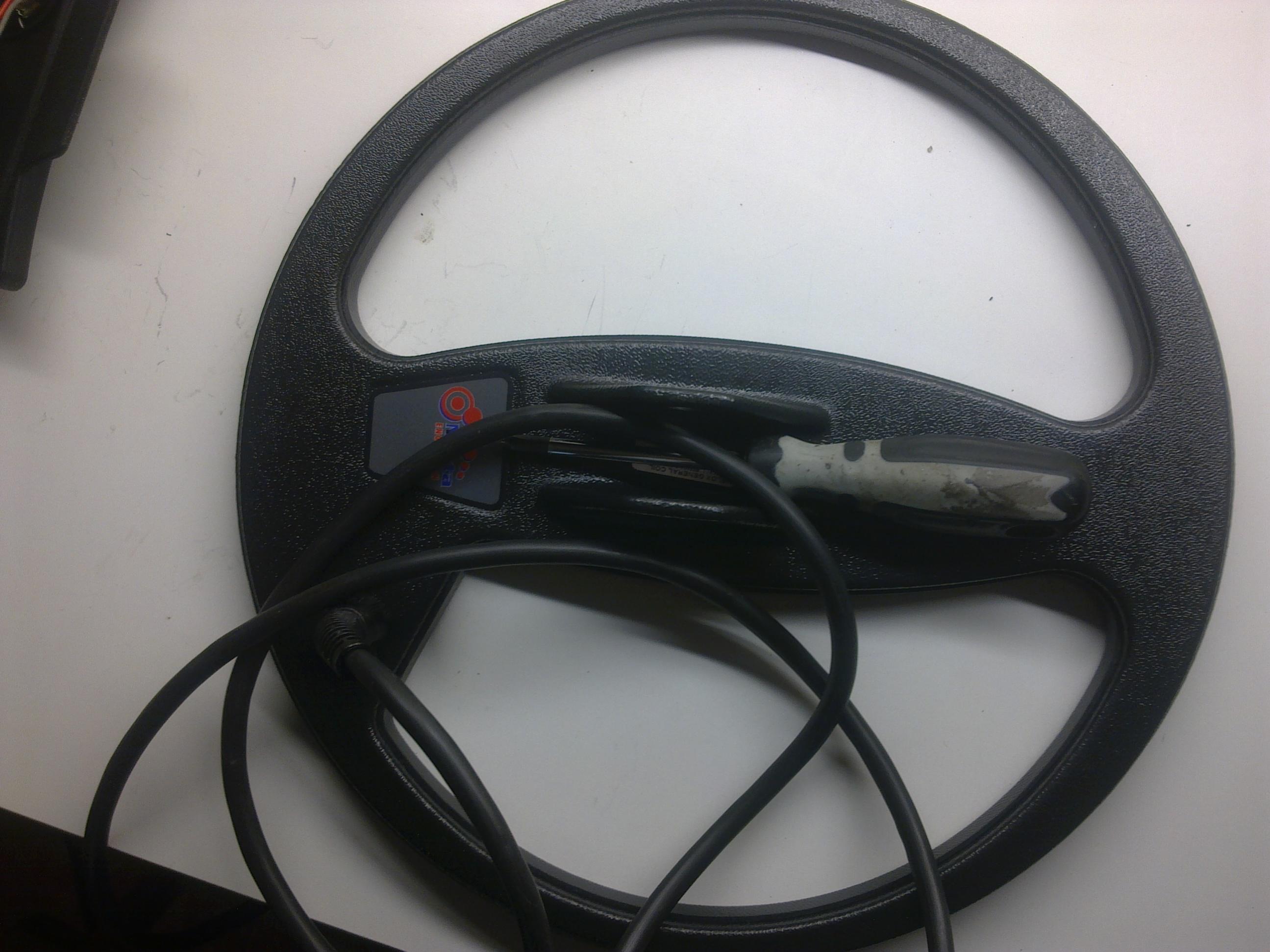

              Can you measure coil inductances?
              If you can; i can compare and confirm (or not) your suspicions.
                Only the TX is measurable and has 1.22 mH 1,2 Ohms.. The RX can not be measured because they have some capacitor in series with the coil and the multimeter does not mark anything.

                  That ugly resin is one HUGE argument against buying it!
                  What a mistake!? Oh man!
                  They shouldn't allow themselves such terrible mistake!
                  Why? Simply because each customer will count on possibility to service device one day, sooner or later.
                  (especially device with such kind of power supply!
                  From my rich servicing experience i can tell that 99% of faults i have seen so far are caused by improper connecting of outer accu's!
                  Usually laymen owners do trying to "amplify" and "boost up" their detectors by adding extra accu and most frequently they mix up wires or trying to use higher voltage!!
                  Minelab's SD and GP are most frequent victims of such wisdom
                  I seriously do doubt that Nokta is so able to provide legal service in each country where their products are sold.
                  They maybe made decent detector with this new one Velox; but they spoiled it much with "protecting" it with resin!
                  Thank you for posting those photos!
                  Very educative!
                  Cheers!
                    So?
                    Close... close but not the same!
                    I can't confirm that coil is having same inductances and resistances as XP coil.
                    Yet... somehow there is a place for suspicions, because: Velox TX inductance is as that higher than XP coil inductance - as Velox frequency is, at the same time, as that lower than XP GMP frequency! Ha!
                    Somehow those do suits logically!
                    Although... let's be serious: this indeed does not mean a thing yet.
                    To be more sure; we'll need to analyze it's circuitry.

                      Definitely there is mcu on the board, PIC or Atmel, i can't tell.
                      I vote for PIC!!!

                        It can last days for grinding and resin potting components on PCB, it cannot be cheap.
                          Oh, there is certain "chemistry" which can do the job much faster and easier!
                          Sooner or later somebody will do that and inform us!
                          So at the end there is one pretty sane question: was it worth to "protect" it like that?
                          I don't think so!
                          Bad idea!
