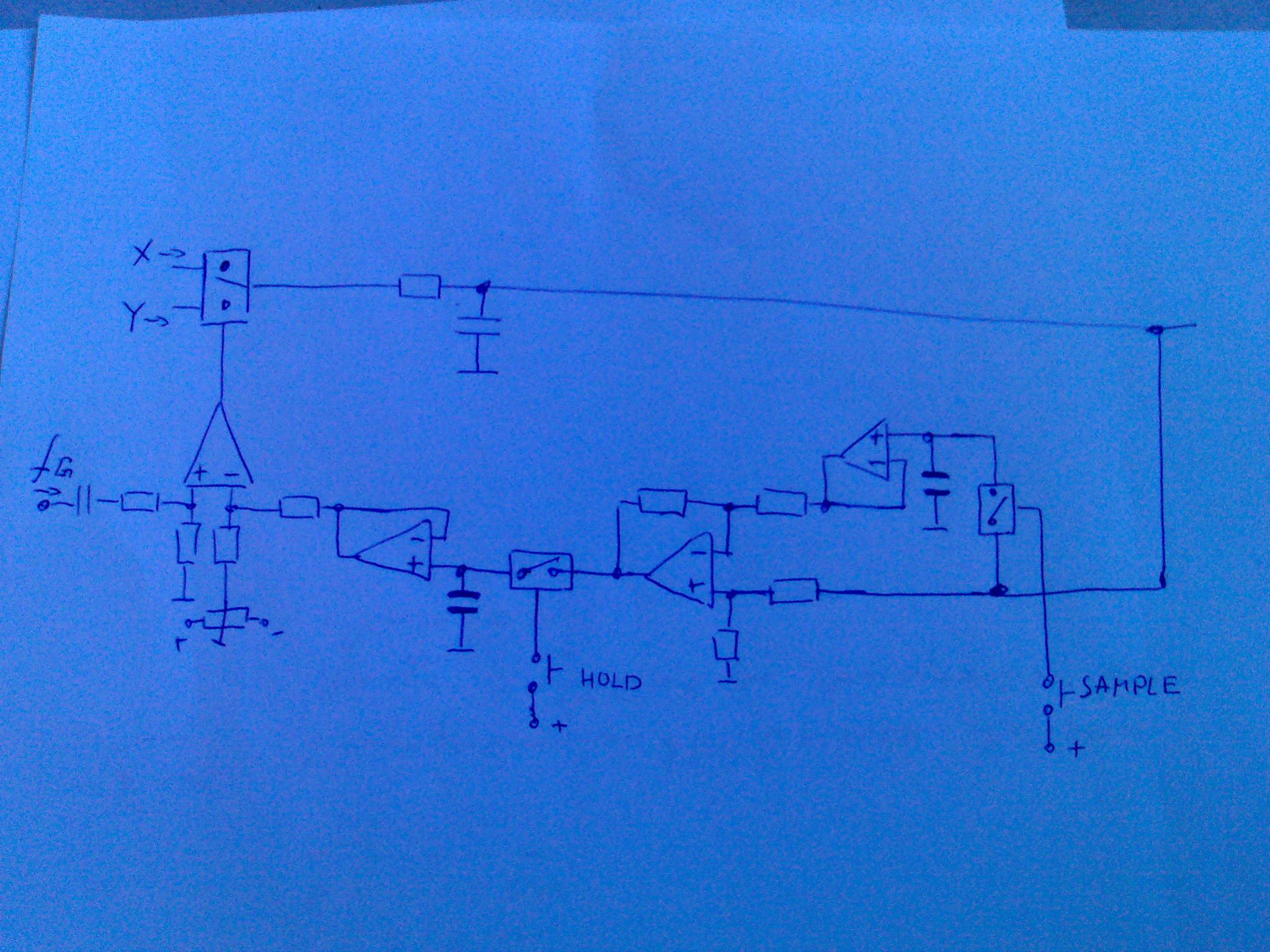

    Anyone got any ideas for tracking ground balance automatically?
    I had a shocker in the summer on mineralised ground. I was only getting 3 1/2" inches.
    When I accurately set GEB - this went to 9".
    Prerequisites may be...
    1) A long time constant, narrow filter in the GEB channel - in order to not respond to targets during sweep.
    2)During cal/capture - holding a button would widen the filter response, speed system up - to make it faster to assess and track GND signal.
    3)Post cal/capture - button release narrows the GEB ch filter to ~5-10 sec time constant to not "see" target response.
    Thoughts - Block Diagrams , principles, architectures (not circuit diagrams) ?

ID:	334190 Hi there. I wanted to experiment with something. I have some ideas I want to share one of them with you
      http://www.md4u.ru/viewtopic.php?f=77&t=5408
        The simplest variant is one microcontroller and one digital potentiometer. Also, you can adjust track speed

                I think that most interesting thing we can try to resolve here should not be Autotrack - but realtime and fast GEB monitoring; exactly the same as it is done at Deus.
                I found it as most usefull and helpfull feature at Deus.
                So; goal would be to design GEB monitoring circuitry which will constantly "read" ground signal and indicate it on LCD display using cyphers.
                User than will observe those cyphers and if needed will manually readjust GEB knob to suit present soil conditions.
                Such design can be made in manner of stand alone addition to already existing detectors, simillar to VDI we have here as project on forum.
                Indication can be LCD with cyphers, symmetrical VU scale, additional background audio channel (low tone bellow zero, high tone above zero, adjustable zero width) etc...

                  Sorry Ivconic - your post appears to contradict itself ??
                  Auto GEB is not good, Auto GEB is actaully quite good..
                  I can imagine taking a long time average is the least useful as you are Geb is balance fram old history, not where your coil is!
                  So a real time system is favourable..
                  Any block diagrams - nice and simple like
