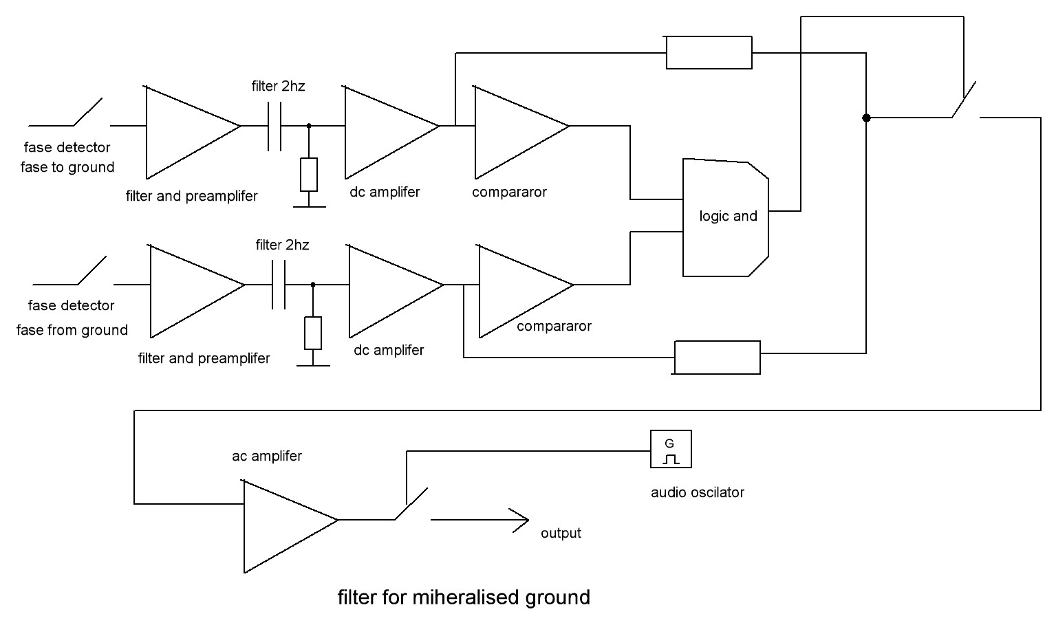

                      A filter with 1 MF and 220K would be ok for an all metal channel but for the disc and gnd channel it would be pretty useless in mineralized soil wouldn't it. That cut off freq is less than 1HZ.
                        Actually it is the other way around, but according to my own observation the typical 10Hz cut-off is waaaaay too high. It's main benefit is in fighting the 1/f noise, and while the garden variety op amps suck in this department, a good chopper stabilised DC amplifier feels right at home. DC/Offset/mineralisation blocking functionality is just fine at much lower cut-off frequencies than 10Hz.

                          Principle schematic motion filter for bad ground.Real detector work.Click image for larger version
