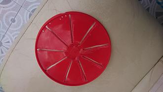

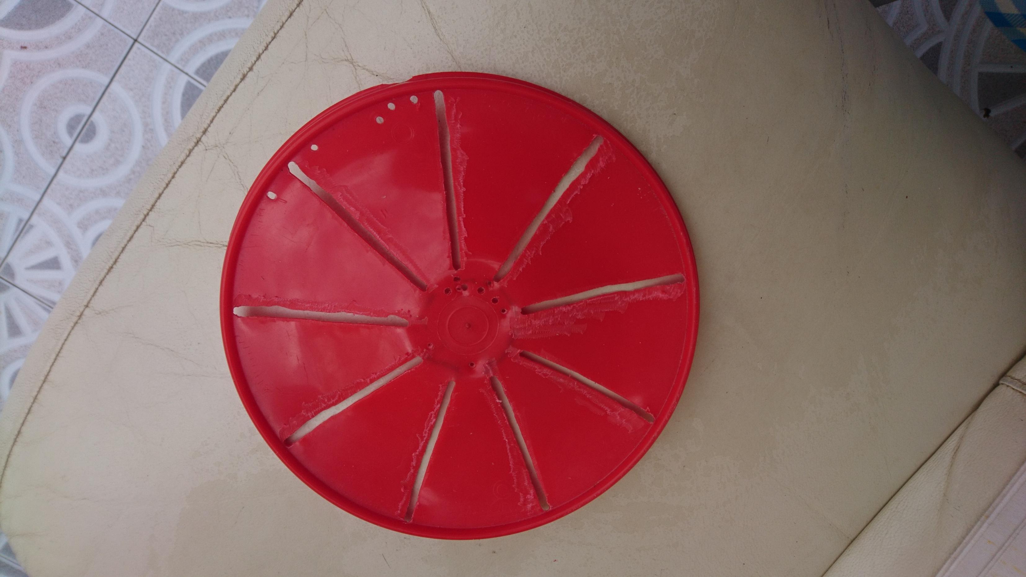

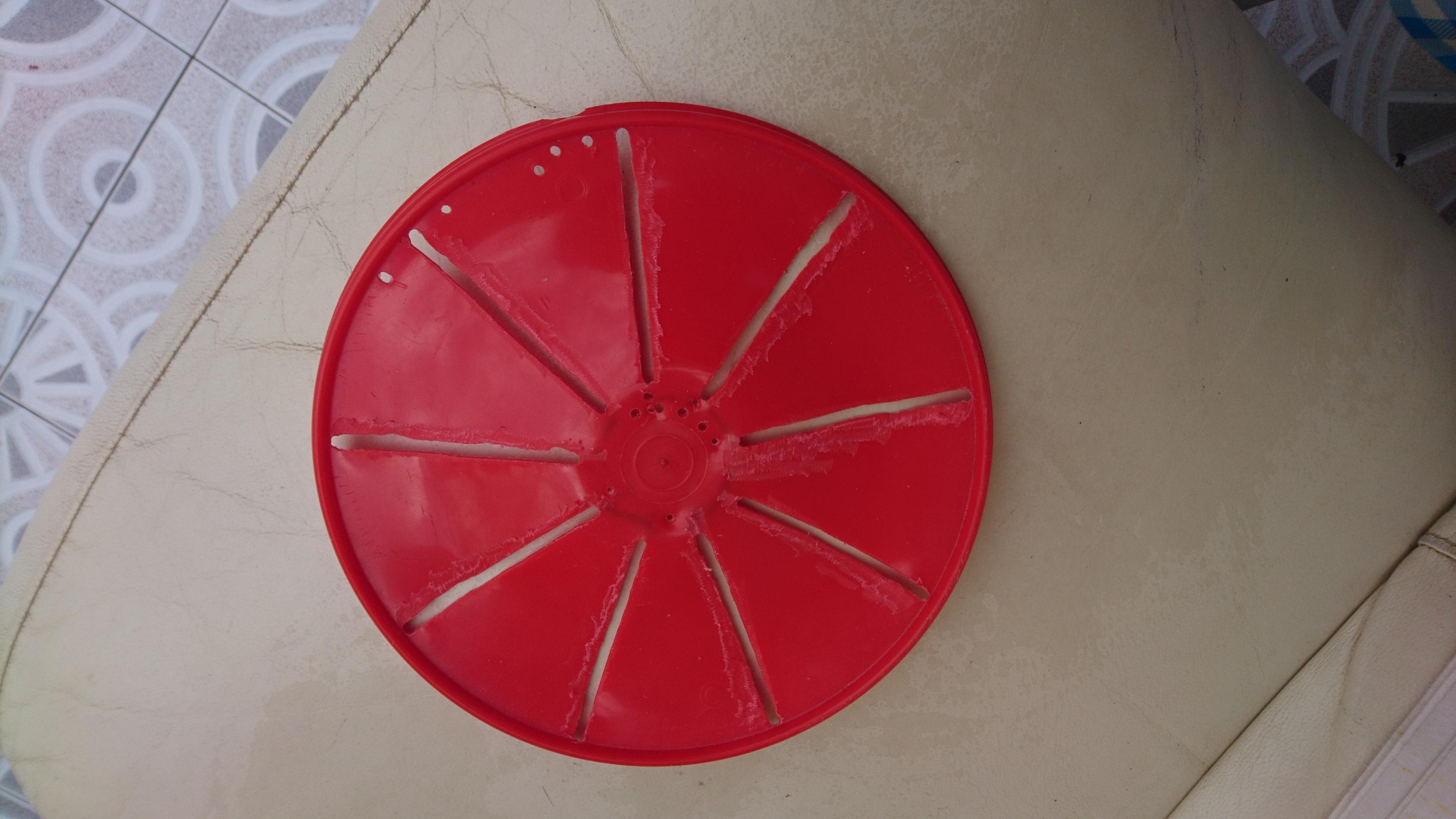

          • I built this from a kit I got from Teemo just over a year ago. I made a 25 turn Spidercoil O/D 22cm and 6cm I/D. I used 1mm speaker wire with a total O/D of 3cm. resistance was about 1 Ohm no idea about the inductance but it worked. Detection depth was very poor, about 5cms for a small gold ring and about 7cms for a 1 Euro coin. All this in free air. Yesterday I unwound the spidercoil and recovered the wire about 14 mtrs. Does anyone else agree with this poor performance? See attached plastic former that I used. Click image for larger version

            • I unwound the coil former and pile wound a 22 cm diameter coil with 30 turns of the same speaker wire. Air tests showed it to be much better, detecting a gold ring at 20cms, a stainless steel watch with stainless strap at about 30cms and a pair of pliers at about 40cms. These tests were done in the 3rd position which seems to be the most sensitive. In the 1st position the ring is clearly detected at about 15cm. I will knock up some sort of support for it and check it on the ground.
              Cheers
              Mike
