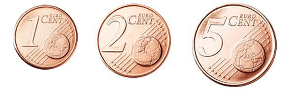

                      Re: RESONANCE FREQUENCY
                      Ferrous coins (for example 1, 2 and 5 eurocent coins) have RESONANCE frequency (electrical resonance). This was described in details here:
