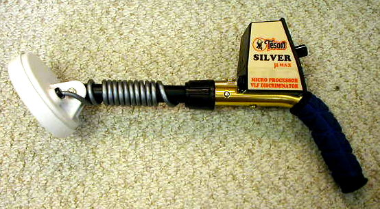

            Sid, I can explain. take Tesoro Compadre and make like you see on this photo, you will get the extra depth.
