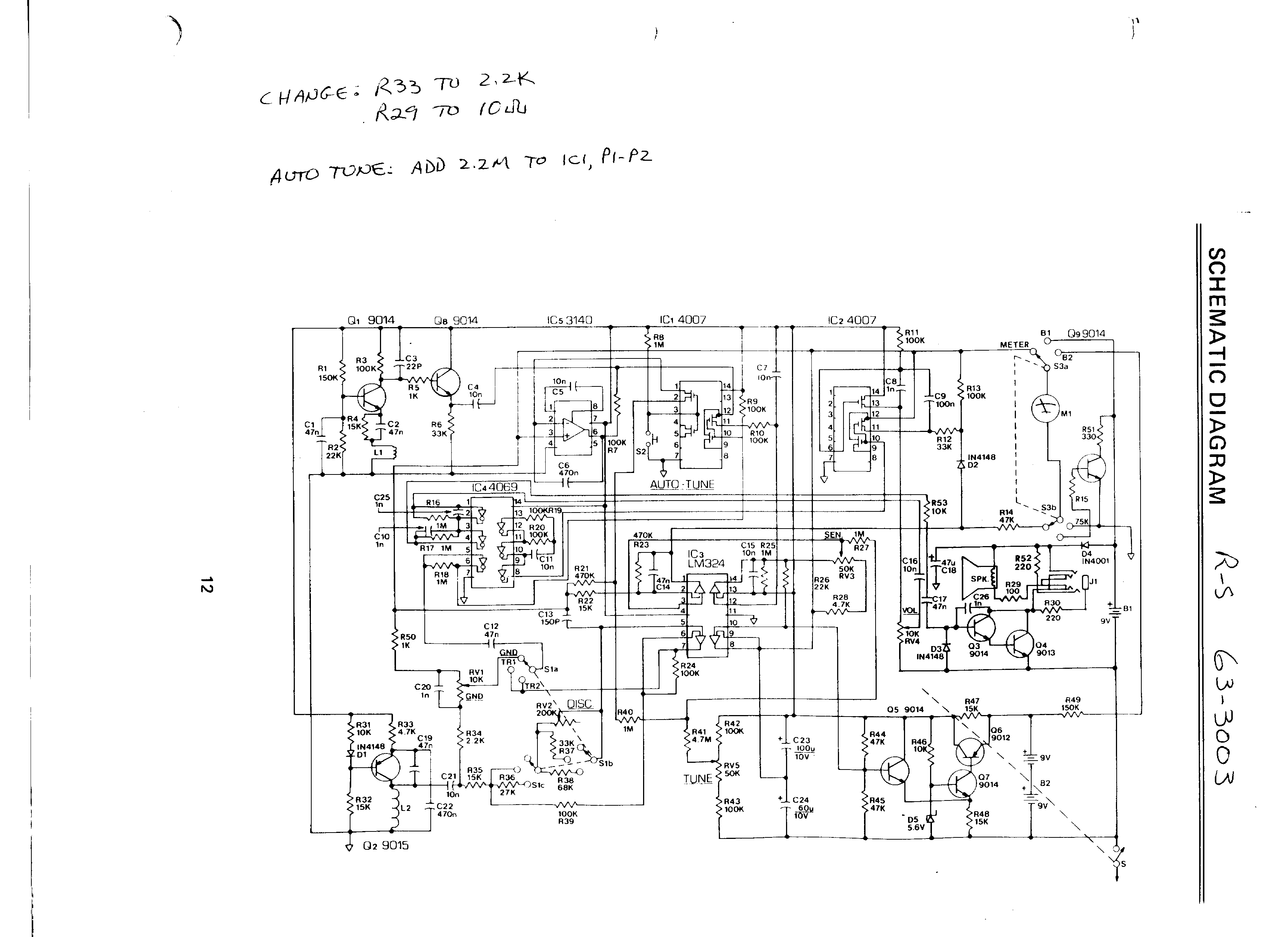

    Has anyone got a circuit diagram for one of these , as they often turn up cheap at boot sales or on e-bay etc. , I know there's a reason for their low 2nd hand prices, but they must be a cheap way of experimenting ?

        I had examined the detector electronics a tiny bit and the design is the basic sync demod, VLF design from the 80ies, the real problem with
        the detector is not the electronics, its the
        search head, open it up and rewind the RX coil and put in som glue while you wind it and
        let harden, then you will have a stable RX coil, then glue the TX coil and let harden. Now
        aling the search head so the picture on the scope gives a dip in the recieve signal or
        dissaper (cant remember wich) then glue the
        RX coil to this calibrated position.
        Now, fill up the entire search head with som epoxi or any other plastic solution that
        hardens into a "non movable mass" and the detector will perform a lot better!
        No, i dont have the schemos!
        The one i bought new costed 80usd (translated)
        and was absolutely terrible until modified.
        Reg

          I have the diagram
          I can send it via email to anyone interested.

                  Here it is ->
                    4003

                        Micronta 4003 RX rewind
                        Hi I know this is an old thread, but I wondered when you rewind the RX coil do you just rewind it to the original spec (i.e same gauge wire and same number of turns) or do use a different spec. Just wondered rewinding it helps.
