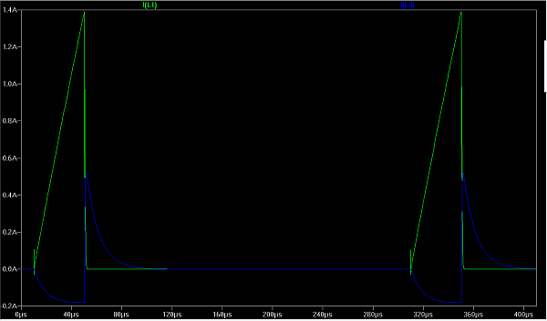

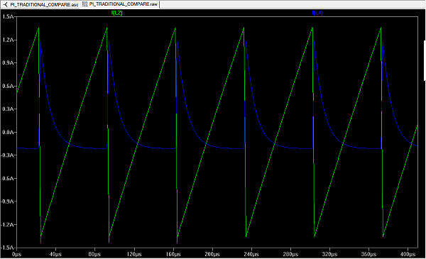

          Attached is a simulation of a traditional PI TX current pulse and the corresponding target response.
          TX=12V=40us Power consumption=100mA
          The yellow trace is the TX current wave form.
          The Blue trace is the Target response wave form.
          The second simulation is a power recycling PI, notice that there are many more pulses per second, for better S/N, by integrating more pulses.
          TX=12V=67us Power consumption=26mA

                    Hi Tinkerer, your first graph(classic PI) I can understand, but what is the circuit for the second(power recycling)?
                    The second, power recycling circuit is the classic TEM circuit. As you see, it gives twice the amplitude of target response and uses one quarter of the power.
                    I have posted many versions of the circuit, but I will post it again with further explanations, later today. As Aziz commented on your circuit, it is a mini TEM, so you got close to it yourself.
                    The classic TEM TX will probably work very well with your signal processing.
