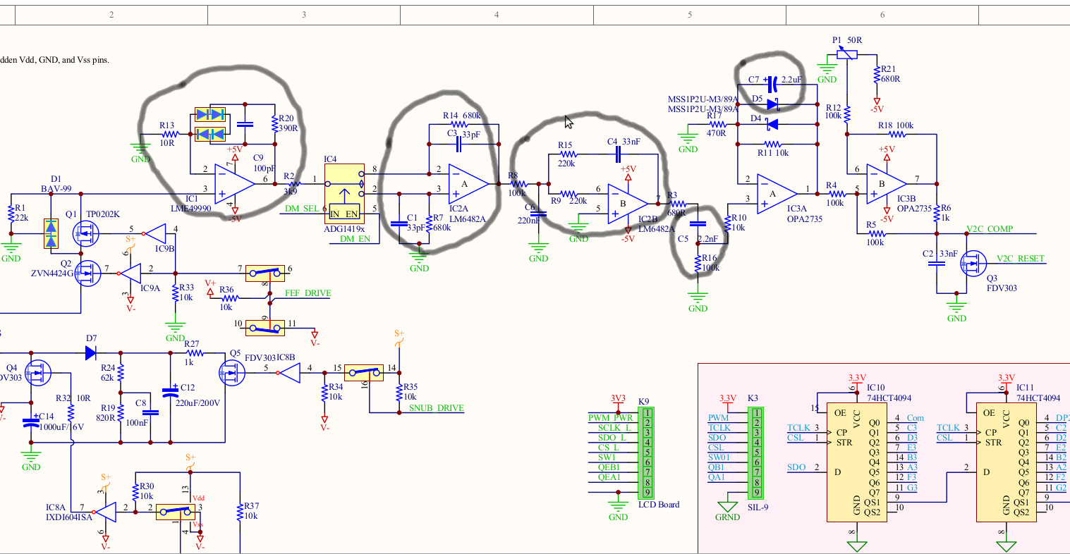

    Hi Pete your schematic shows nothing but 6 red dots in the pink box.
    Regards, Ian.
    • #62
      Ok ,
      D 2 Not marked on Drawing above IC1
      D2 consists of 2 ea BAV99 ,
      C9 should be 100P,
      Between R13 and R20 there should be a direct connection, Unless this is one of those mistakes that BW had inserted. Could be taken care of with a marked out line for reference going forward so as not to forget. I do not know ?
      Please confirm my findings.

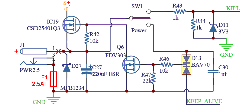

        Re: Fuse for battery
        Pete, connect a fuse in series with lead 1 or lead 2 of supply connector.

          HI Pete,
          Just a few mistakes I have noticed.
          As Kahles has stated the feedback loop on the preamp(ic1) is all stuffed up!
          C5 should be 2.2uF not nF.
          Pin 20 on ic5 should connect up to the junction between r19 and r24.
          I am assuming that all ic's have their own bypass caps on the power rails?
          The DAC lines go nowhere, where do the headphones hook up? Must dig out the original schematic.....
          C14 should read 10,000uf, not 1,000.
          Also up the top with the line of ic's, try and line them up so the signal flows straight Corners create harmonics
          Cheers Mick
          • #65
            Or better still a 1A thermal breaker, self resetting.
            • #66
              Mick, the diode D27 will destroy the battery at reverse connecting. The fuse should blow quickly because the battery is expensive. I'm not familiar with thermal breakers. How quick they break the circuit?
              P.S. I searched the WEB. This is not suitable because they have high ESR.
              • #67
                Thanks Carl.
                Here you go Pete. All problem areas I haven't fixed them for you but if you have bug's schematic you'll see the mistakes in the circled areas.

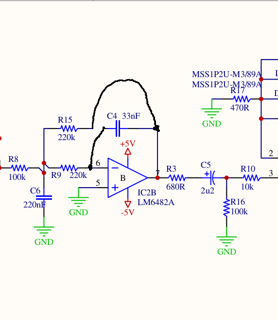

                • #68
                  Pete,
                  I'm definitely over it.
                  Originally posted by KahlesMilcon View Post
                  Ok ,
                  C9 should be 100P,
                  The error here that Mick has also circled is that the diodes aren't connected correctly. They should be set up so there are two sets of diodes in series, in anti-parallel between the negative input and output. This effectively gives unlimited feedback current once the output exceeds two diode voltages, stopping the amp from going into saturation so it recovers faster.
                  Midas
                  Edit: Also and closer to what Kahles was talking about R20 and C9 should be across negative input and output.
                  • #69
                    HI Mike,
                    li-ion batterys can withstand some pretty horrendous short term abuse. I just had a quick look and one thermal breaker I found 1.5A breaker had a 0.12r contact resistance, I can live with that. These things trip pretty quickly and I have used them for this purpose before. Beats carrying a pocket full of fuses out bush!
                    http://www.jaycar.com.au/productView.asp?ID=SF2281
                    Cheers Mick
                    • #70
                      Surge protectors such as ICP-N15 are faster and cheaper, and they work forever
                      • #71
                        The even newer, more improved, less buggy QED schematic - with ANSWERS!
                        You're all a bunch of *******s! Talk about tough bosses! Pulling my beautiful schematic to pieces before my eyes! Boo hoo hoo...
                        I've attached the latest schematic below. I hope I've addressed all your very much appreciated feedback and comments. To make sure, I'll try to answer youse all one list of problems at a time.
                        If I've missed anyone out, or missed making a change, please let me know. Again. Sigh.

                        Just to help you out Pete, Here is a picture with five problem spots circled. If you have the QED schematic you'll be able to quickly see the errors in your version. I hope this helps you.
                        I should piont out these are not the only errors.
                        Thanks very much again, Mick. I've addressed the 5 problem spots now, I think. Some of them are duplicates that other folks have mentioned too. Some of them are detailed below. But thanks for going to so much trouble.
                        Love the wiggly circles... were you drinking (or smoking) when you drew them? OT : I suppose you know about Giotto the painter? The story goes, he was told to present an example of his work to the Pope, in order to be approved for a job in the Vatican. Instead of painting a picture, as you'd do, when the courier came to pick up his sample, he just picked up a brush, dipped it in paint, and in one sweep drew a perfect circle on the canvas. When the Pope saw how perfect the circle was, and how he'd painted it in one swipe, Giotto immediately got the job. There's even a saying, I understand... "As round as the circle of Giotto"...Sorry, where was I?

                        And finally (for now, at least) :
                        Originally posted by Midas View Post
                        Pete,
                        Midas
                        Midas, I really appreciate you taking the time to explain what the problem is and how it's supposed to work in the circuit. I had no idea about why I keep seeing antiparalelled diodes (I had to check my spelling on antiparrallellledd) in so many circuits, but your explanation was so clear I had an AHA!! moment. Thank you - I love AHA!! moments. They make my day.

                          • #73
                            One spot still had an issue correction shown below.
