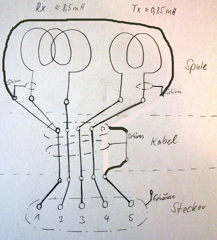

            See same question in the Coil forum section. I posted photos of my GB2 plug.

                  Dave, Thanks for the reply. The wires are pulled out of the plug that connects to the detector box. I looked at another coil plug and it has 5 wires but mine only has 2. I trimmed back the insulation for 1 1/2 inches and there are only 2 (two) wires, orange & green. I can't imagine how it worked with only 2 wires. It should be a simple fix but I suppose I'll have to send it to Texas.
                  Just two wires is an impossibility, there must be more than two wires. Strip back the insulation some more or maybe within the two wires are two more wires. Strip back either the orange or green, there's bound to be more wires.
                    another possibility is your detector is a pulse induction detector posing as an authentic gold bug 2. where did you get it from? Hopefully not from china?

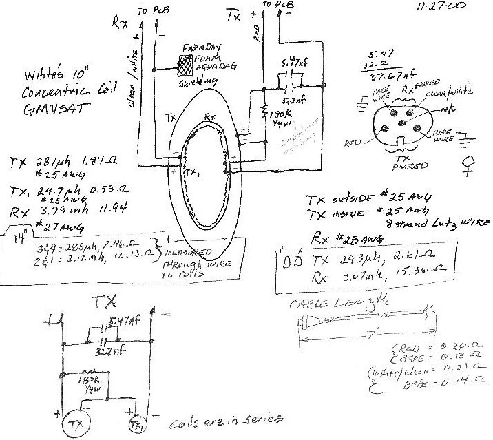

                      Schematic for gold bug 2 . Thanks .
                        5 '' coil
                          Coil specs for the GM and GB. This may help to design a gold coil. Basically RX is around 10xTX. Far removed from the specs of vlfs. This may be a good laymans indication for gold detector design or back-engineering.
