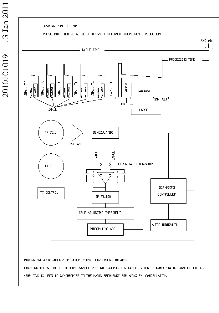

      Gosh the diagram looks pretty simple to me,putting aside "S2" ..... to null out the ground response samples S3 and S5 are the same sign so you combine them to equal the ground signal in sample S4 using an integrator and then you have a null summation,S1 can be used to help remove static fields such as earth fields and remnant magnetism that`s associated with some ground types.
      A good starting point would be "if the diagram is scaled correctly" is to have S4 the same width as the TX period as shown in the patent diagram and S3 appears to be between 10 to 20 percent of the TX period and S5 i imagine is adjusted to achieve a null summation with S1 adjusted to cancel static fields.I think this interpretation of the diagram would actually work.
            Zed
            That's good, Zed. Many thanks.

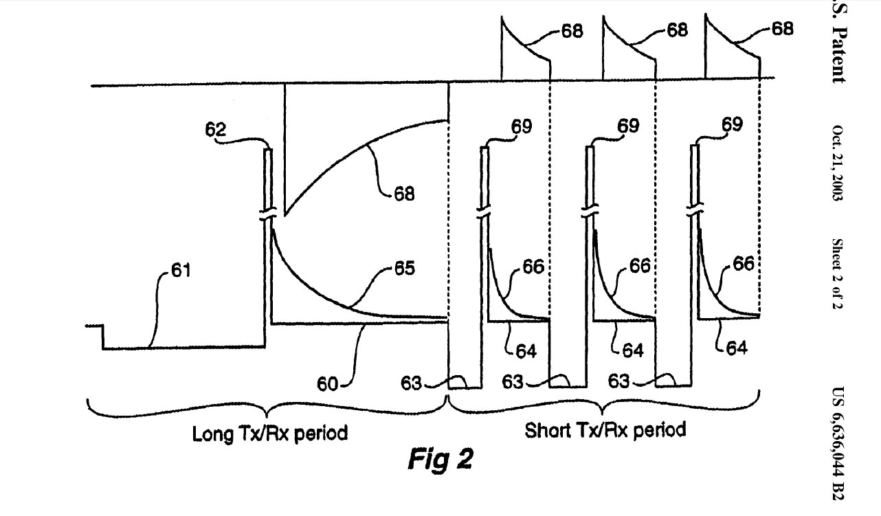

                  No, TDI works differently. If you look only at the claims and nothing else, the patent makes no sense. Read the whole patent. What is it that Minelab is really claiming? When you deal with patents, you have to take it as a whole even though, legally, the claims are where the rubber hits the road (where you can get sued). The body of the patent is supporting evidence. BTW, I've never looked into the method described in this patent, and likely never will.
                  Patents are often written with seemingly duplicate claims, differing only by the word "method". You not only want to patent the idea, but also the method of implementing the idea. This is standard course for patents, nothing unusual.
                  - Carl
                  Cheers Carl, right you are. Just me being lazy. I found the whole patent with all the diagrams and its more about using long and short TX cycles to help with GB, nothing like the TDI. But it baffles me how the claims are allowed to be written in such vague all inclusive terms when as you say its where the real legal meat of a patent is supposed to be. Incidentally I reckon this is probably the patent that has Bugs in spot of bother.
                      No, the patent has nothing to do with long/short TX cycles to help with GB. Again, read the whole patent. The example given in the preferred embodiment happens to have 2 TX pulse widths, but the method being patented has nothing to do with multiple pulse widths. From what I know of the QED, it is nowhere close to this patent.
                      - Carl
                      • #56
                        - Carl
                        Like Carl says. ....you posted method "B"....
