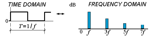

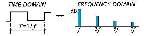

    Here's the first question:
    Showed rectangular wave generates series of odd harmonics. Modify signal parameters so to obtain both odd and even harmonics. It is necessary to obtain the frequencies used by MINELAB: 1.5kHz, 3kHz, 4.5kHz, 6kHz, ... etc.

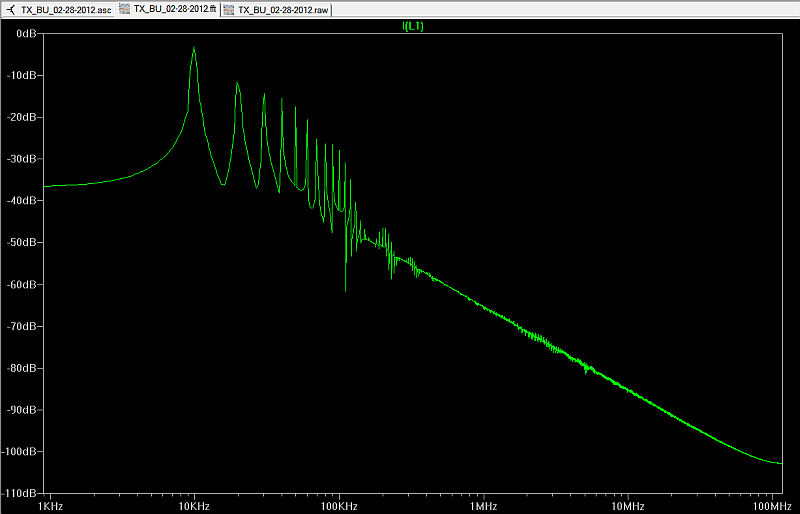

    ENERGY EFFICIENCY OF RECTANGLE PULSE TECHNOLOGY
    Attached diagram shows that energy efficiency of waveform in post # 1 is worsened.
    See what is the difference between this diagram and that in post #1.
    Remains you to insert the difference in the frequency spectrum.

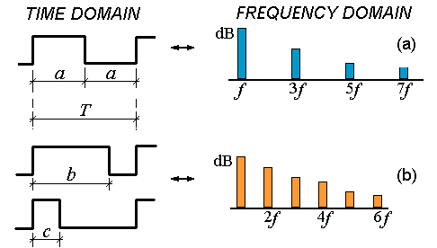

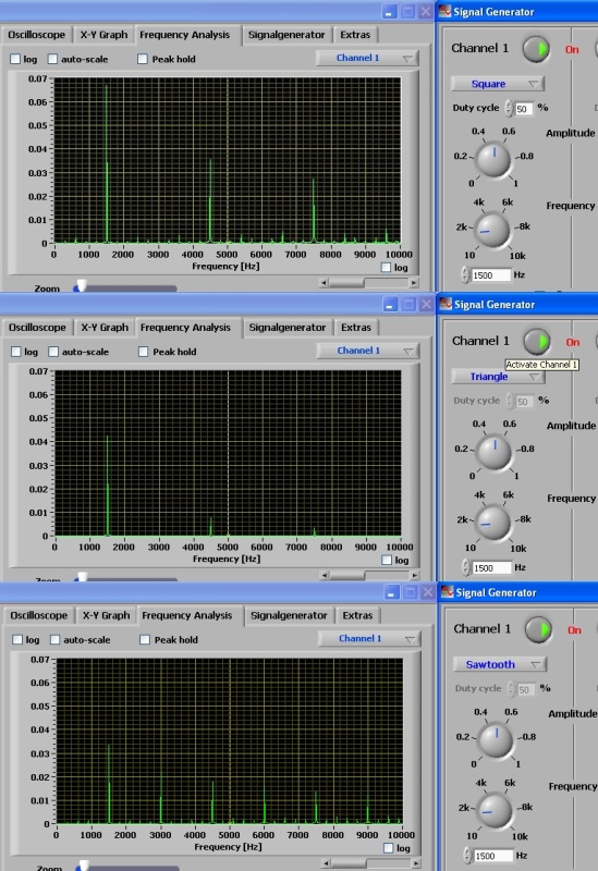

      the simplest way is to "modify" the duty cycle of the square waveform, but depending from the this ratio at some harmonics there will be a hole.
      Another way is to use a sawtooth waveform.

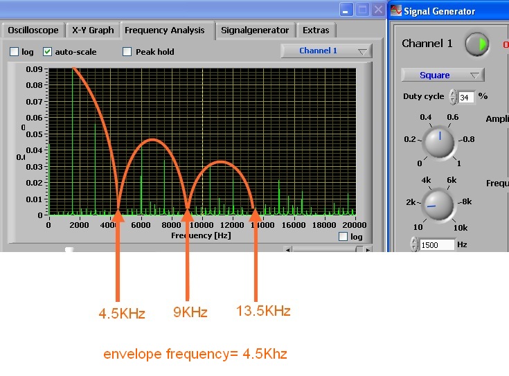

        DUTY CYCLE
        For "random" TX freq take a look at this:
        http://terraplus.ca/products/electromagnetics/gem2.aspx
        I can't see the hole.
        Please show suitable duty cycle for frequencies used by MINELAB: 1.5kHz, 3kHz, 4.5kHz, 6kHz, ... etc.
        Here is a drawing for editing.
        To spare your time, I will make and post a drawing with parameters of sawtooth waveform.

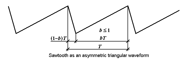

                  SAWTOOTH AS AN ASYMMETRICAL TRIANGULAR WAVEFORM
                  To bill512 and all,
                  Does anyone have a signal generator that can show the frequency spectrum of this asymmetric triangular waveform?

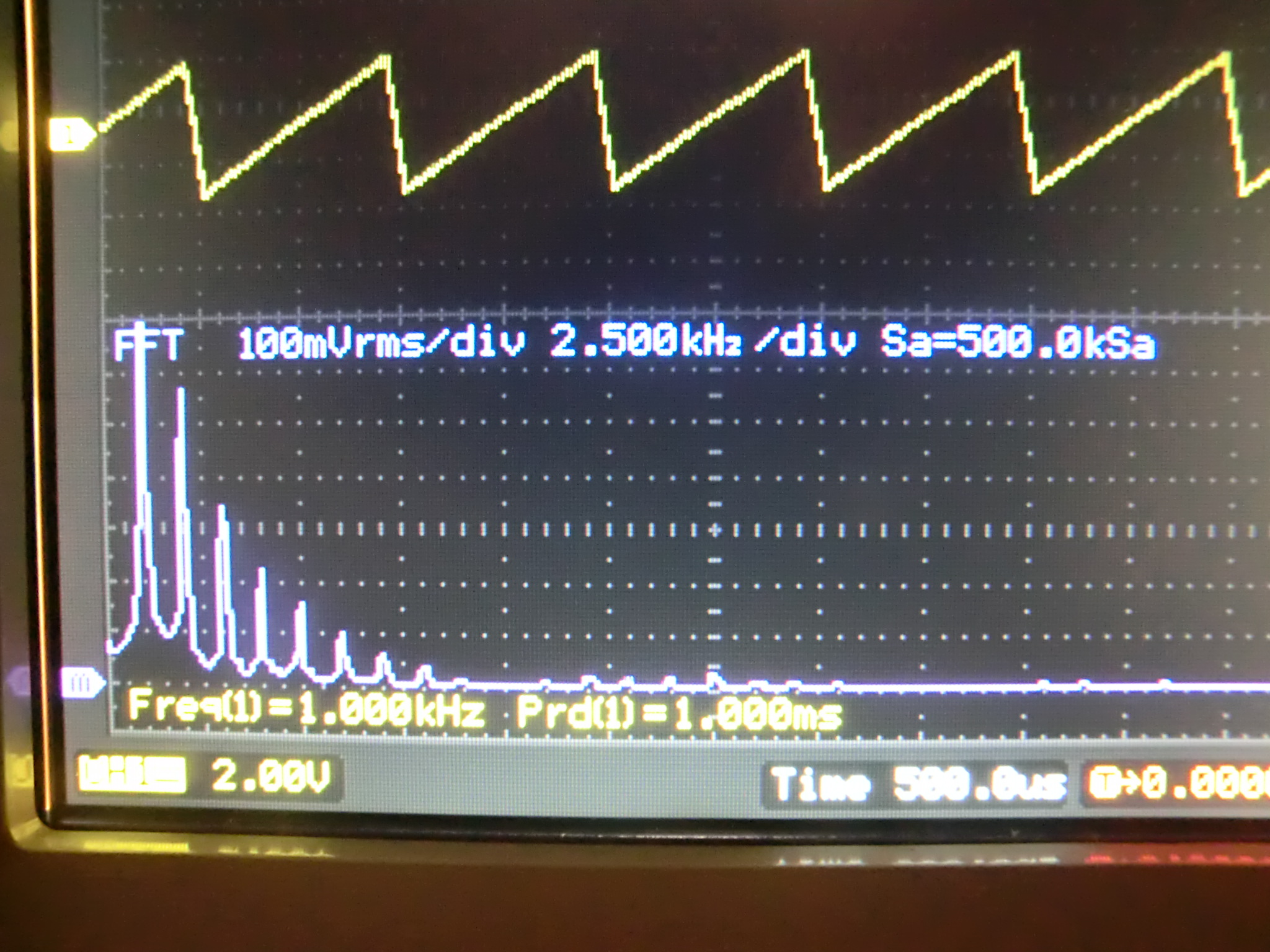

                    Here you are:
                      To bill512 and all,
                      Here is the FFT of the TINKERERS TX, a saw tooth wave form with the long ramp of about 90us and the short ramp of 9us
                        I need software that can show me what happens in Frequency domain when amended parameter "b" (explained in post # 9).
                        Can somebody show me a link where I can download for free a signal generator with Frequency analysis similar to that used by Bill512 in posts #5 and #6?

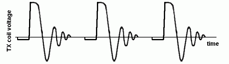

                        In next posts I should show the frequency spectrum of a "ringing" TX pulsation (underdamped PI metal detector or without damping resistor).
                              Hi Mike,
                              nothing fancy,just simple,free and useful :http://www.zeitnitz.de/Christian/scope_en
                              ("... free of charge for private and non-commercial use in educational institutions ...")
