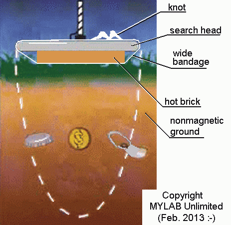

        GENIAL IDEA
        I have an idea how to use a lightweight PI machine in places without high mineralization. Simple make search head weighty and mineralized.
          Too late! You can't patent it now it's in the public domain. Could have called it a BB (Brick Balanced) coil. Why would you want to use it over non-magnetic ground? Suppose the susceptibility would concentrate the field slightly. Better to use a slab of ferrite.
          Ferric Feet.
            Ferric Feet.
            Eric, You started to become more and more made of Fe (iron).
            Since you already was Ferric Toes, now you became Ferric Feet.
