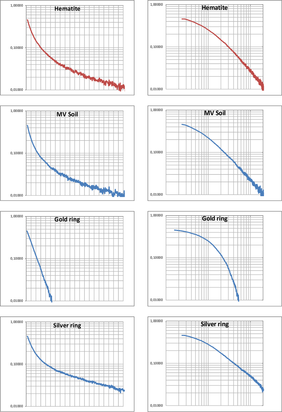

          Hi Eric,
          This confirms what I have read in several documents about magnetic viscosity. However, among the many samples I tested there are some with slightly different decays. How similar should they be?
          Below are some decay curves. Test setup is a small cylindrical mono coil, samples are in film containers inside the coil, standard PI waveform with 50µs on and 2µs off. Decay curves start approx. 5µs after the 2µs pulse. The TX coil decay curve was removed in the oscilloscope by subtraction, i.e. the plots show the pure decays of the samples. All initial amplitudes are equal so that the curves can be superimposed as in plots D) and F).
          I actually made these to show how close the viscosity decay can be to that of metallic targets. It is very easy to get almost the same decay curve with two rings with different TCs by simply varying their distance and angle. This simulates the problem with the detection holes in GB systems that subtract a later sample from an earlier one.
          Samples:
          A) Hematite powder (alpha-Fe2O3, could also contain some amount of gamma-Fe2O3/maghemite):
          http://www.kremer-pigmente.com/en/pi...ght-48100.html
          The data sheet says the predominant particle size is 90nm
          http://www.kremer-pigmente.com/media...lic/48100e.pdf
          Maybe I try to convert some into maghemite as Aziz suggested here:
          http://www.geotech1.com/forums/showt...ace-!!!/page59
          B) Magnetic viscosity soil from my area (concentrated with a magnet)
          C) A thin gold ring with one TC of 13.5µs
          E) A thick silver ring with at least two TCs of approx. 15µs and 120µs
          Thomas
          [ATTACH]23599[/ATTACH]
          Hi Thomas,
          Nice set of curves, but it is difficult to see any differences between magnetic soil and metal targets with a linear display. If you can, try and convert them to 1) log amplitude/linear time. 2) log amplitude/log time. Targets like a ring will have a single exponential and have a straight line slope in 1), while ground will still appear like an exponential. Ground in 2) will appear as straight line slope, while the ring will curve downwards at late times.
          Eric.

                    Hi Eric,
                    Below are the same decay curves with log/lin and log/log axes. Y= amplitude from 10 to 1000mV, X= time from 0 to 200µs. The problems I mentioned earlier are still visible:
                    • The curves for hematite and MV soil are not exactly the same (also easy to see in the lin/lin plot, there the red and blue curves are slightly different during the first 100µs). So my question was, how similar should they be? Also, they do not appear as a straight line slope in my plots. Maybe the TX fields I used were too strong and there is a distortion by saturation effects?
                    • First order (one TC) targets like the gold ring have a straight line slope in the log/lin plot, but as soon as there are more TCs involved (like the silver ring), the delay can become very similar to the viscosity decays.
                    If anyone wants to take a look at the data, here is the Excel file: decay_curves.rar
                    Thomas
