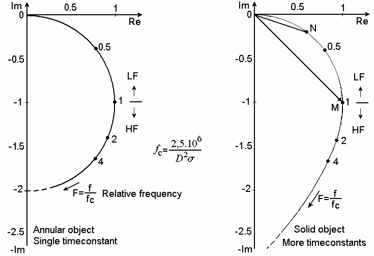

        Was ist das FFT?
        Hi all,
        has anyone made the frequency domain (FFT) response of various targets (ferrite, magnetite, maghemite, iron, copper, etc.) on an induction balanced (IB) coil configuration and a wideband continious wave transmitter?
        This is somewhat enlighting and reveals everything and the holly grail of MD.
        Aziz
        Aziz, Do not expect answer.
        The FFT appears in the 60ties of the 20th century. Because of its power, it quickly begins to apply. Do not expect the experimenters in this forum soon to apply it. Your question is too modern for them.
        Five years ago I asked the experimenters in this forum for something that is much more easy and enough old because it matches the level of human knowledge in the 19th century.
        I came 5 years ago on this forum with a question that no answer to this day. See my first post on the forum and read what desperate answers received:
        Forum participants did not know that to design even a NARROWBAND metal detector they need WIDEBAND information how to select operating frequeincy.
        Since after years no one has shown that he uses Frequency spectrum for measurement of targets, I decided to show how to make it:
        I hope that someone experimenter will start to use broad band spectrum of Frequency domain. Then he will understand that he need FFT.

          Are you both (Aziz and mikebg) selectively reading the posts in this thread?
          If not, then how did you miss the following post by Carl?
          In the context of my current project, which is a hybrid VLF + PI, it's very easy for me to think about, and even simulate, this circuit in the TD. So I got to thinking about what it would look like in the FD and, holy smokes, it would be a huge spectral mess. I think if I had used FD I would still be in theory-land, instead of field testing.
          mikebg - By the way, no answer at all from the Scientific American archive site. Perhaps it's a dead link, in the same way as Aziz's "holly [sic] grail of MD".
          Note: The Latin adverb sic ("thus"; in full: sic erat scriptum, "thus was it written") added immediately after a quoted word or phrase (or a longer piece of text), indicates that the quotation has been transcribed exactly as found in the original source, complete with any erroneous spelling or other nonstandard presentation.

                        All for nonferrous conductivity is predictable in Frequency domain, because we can use normalized locus.
                        Look that a wideband metal detector can show if the target is as ring or not.

                          Mike - you're not listening to what other Geotech members are saying. Or, if you are listening, you're not taking any notice.
                          Please go back and read posts #86, #94, #97 and #100.
                          You are never going to convince anyone here of your frequency domain ideas, unless you can prove them in reality, by actually building something that doesn't only exist in a simulation.
                          Go on man ... switch on the soldering iron, and show us the error of our ways!
                            Which soldering iron, Time domain or Frequency domain one?
                            • Mine is Magnastat, time domain
                              • Analysis in both time and frequency domain are viable tools, I don't think it deserves ridicule - but it does deserve some proofing. I assume Mike doesn't have and cannot afford the kind of laboratory setups some Geotech members have, otherwise he would be providing us with experiment journals.
                                Without experiments, we'll just keep on flogging the same dead horse in different directions.
