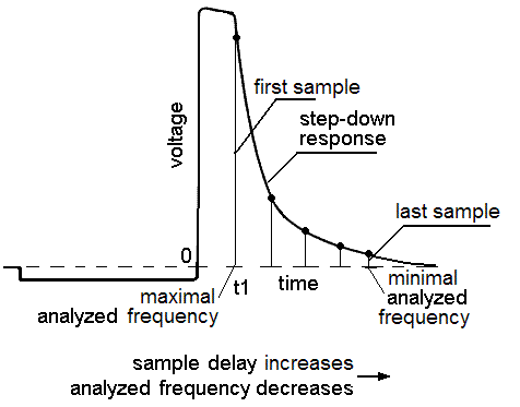

        At conventional PI, the self-inductance (monocoil) generates maximal possible AIR signal. This is valid also for conventional search oscillator used in BFO type metal detectors. All know what is shown in the diagram below. This is the waveform of step-down response of self-inductance or mutual inductance in time domain. Look at how the "flyback pulse" seems in Frequency domain:

          I'm trying to understand the above image. I'm assuming the flat top is about .6 volts. The first sample is over .5 volts. I thought sampling started at or at least close to zero volts. What is the minimum number of coil TC for the first sample. Maybe change is all that matters.
            Do not think of volts to the input of the preamp. Important is its gain and its output. Initially you can't take sample because the output of preamp is saturated. The saturation depends on gain. At gain 1000, an input amplitude more than 8 mV causes saturation (if supply voltage of preamp is 10V).
            If we use the frequency domain to explain this, the preamp appears saturated by AIR signal because it has high gain at high frequencies.
            You are right that change matters. TGT signal appears as modulation (change) of AIR signal with very small modulation index. To increase modulation index, we should suppress AIR signal. Then we can increase the gain of preamp.
