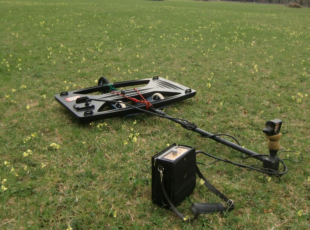

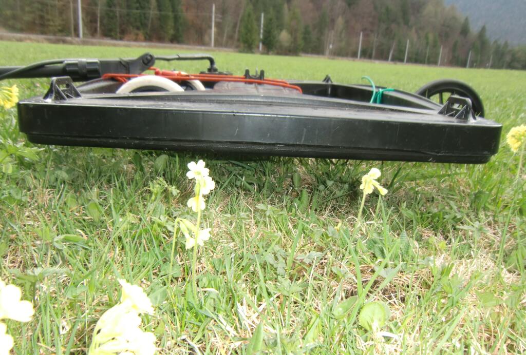

            Now about the 1m coil for the DeepHunter or Jeohunter.
            you can read it here:
            http://www.geotech1.com/forums/showt...ight=jeohunter
            I have reposted for you the pictures below because it also counts for the DeepHunter.
            The coil with my setup is 7-10cm (3-4'') above ground because I used pretty small plastic wheels (13cm diameter or something).
            But this works already perfect seen from the ground-balance-stability at sens. 80-90 at flat and not so high mineral. areas!
            You even could drag the coil directly by some rope over the meadow if the soil is just medium mineralized with 70% sens.
            and some experience!
            What really counts is a good working compromise of different area-situations versus depth:
            This means if the coil is too high (20cm above ground) its better for harsh regions but then its 10cm less deep
            and if its too shallow it may be no longer possible to drag it over not pretty flat areas (over stones, roots, obstacles).
            So 7-15 cm is really the best compromise because its versatile for many different locations.
            Holding or moving with 2 persons the 1meter coil 30-40cm over the ground may still be ok under special conditions
            but it's not recommended because it results in too much loss of depth. The closer to the ground, the better.
            And whats also important is the new reset button of the DeepHunter (or the modded one for the Jeohunter)
            because that way you can work with a super high sensitivity setting and if you hear some error-signal
            its possible to reset it immediatly.

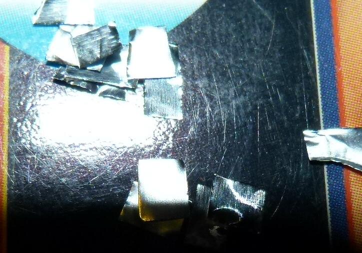

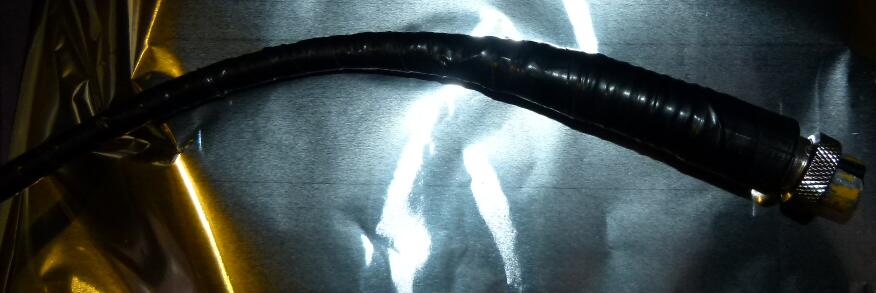

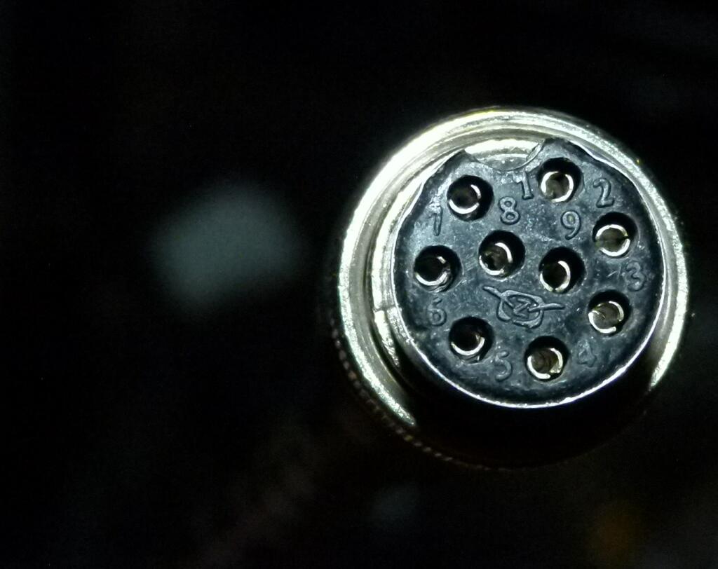

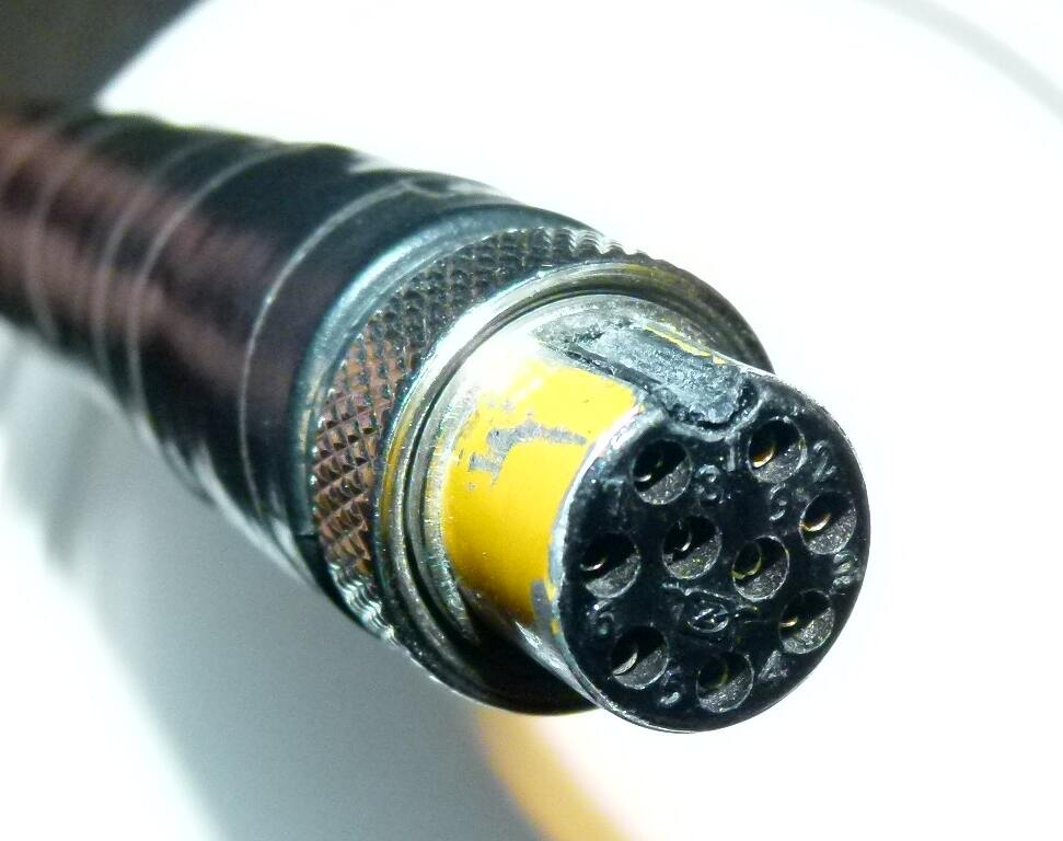

            And now some other important thing and good news how to fix the a few 0,1mm
            too loose DeepHunters coil-cable-connector (this is perfectionism, under usual conditions you will
            have no problems with it at all as long as its not too cold outside and the coilcable get's pretty stiff) :
            http://www.geotech1.com/forums/showt...543#post199543
            After the thin drink-can alu-sheet was superglued around it to give it a perfect halt its a good working way
            to make the whole contact even more stable by shoving some little alu-foil pieces into the contacts!
            This can be pretty simple done by a small needle. Shove it directly inside or even behind the sides of the contacts.
            It should be done not all at once but 3 by 3 or something and afterwards plug it in to test that it still can be put in.
            The only important thing is: Don't shove too much alu-foil into the connector! Ultra thin 1-2mm pieces are just fine.

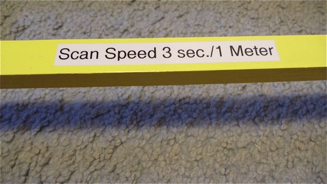

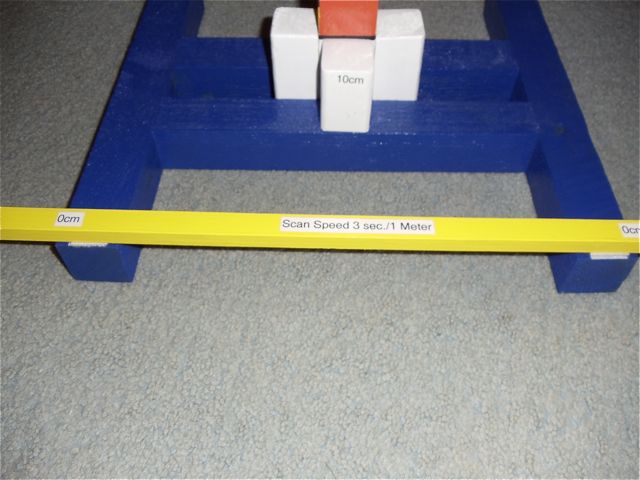

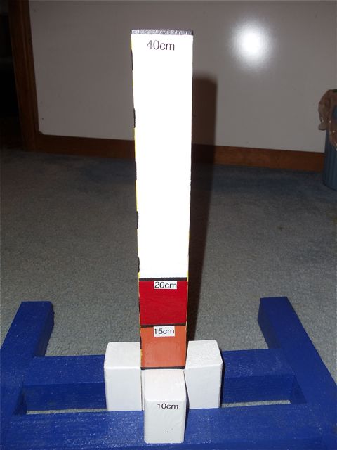

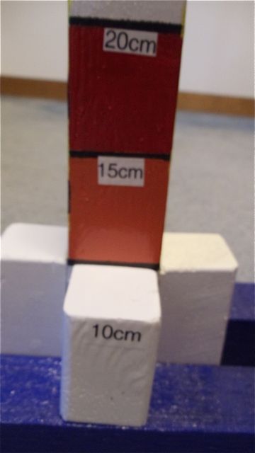

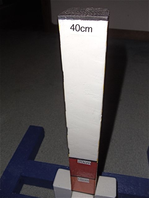

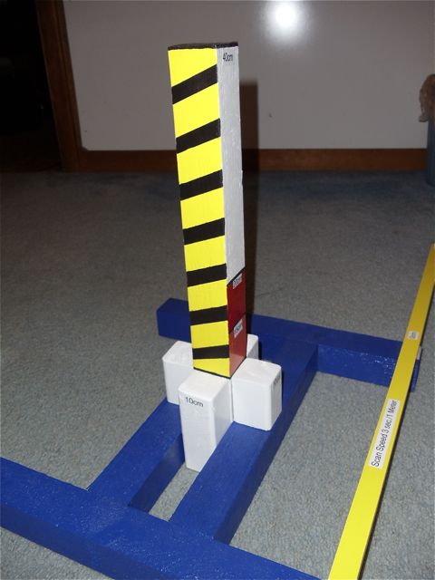

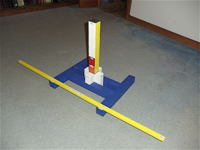

                      Here's something I created this while I wait to purchase a good used Golden King. My understanding is the GK's sweep speed, scan speed, ground balance and scan heights are critical for optimum performance. So I created this device. Click image for larger version

                      • Hi landman,
                        can't speak for the GK cause I never tested it personally but the speed of the DeepHunter and Jeohunter
                        is super fast and even usable for whirlwind-search-method (circle around your own body-axis while
                        moving forwards etc. and making the coil ultra lightweight by anti-gravity-forces).
                        Your construction looks good and you also may create some plastic-trolly for the 1m coil
                        so you can drag it with its broad side forwards.
